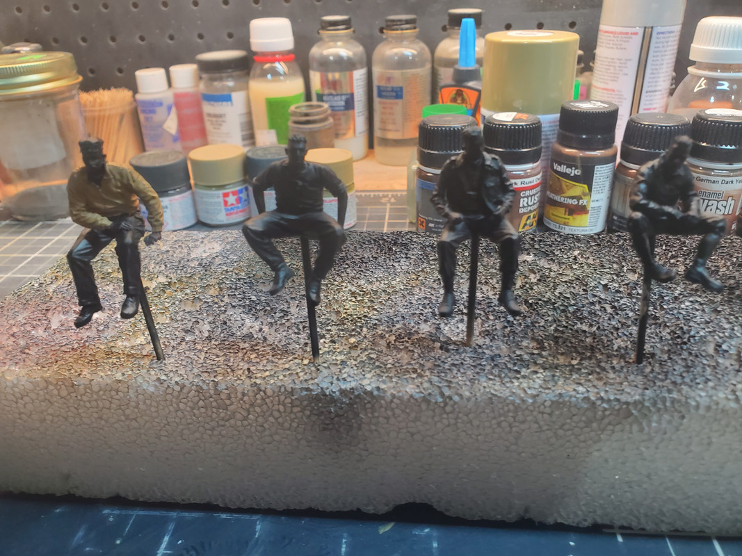

I generally use superglue and toothpick with the end cut for a flat gluing surface, glued to the bottom of a foot (or whatever the ground-contact part of the figure is). It is usually brittle enough to just break off clean when I’m done painting. Worst case, clip it off with a side-cutter and it maybe needs a swipe with a file to clean up.

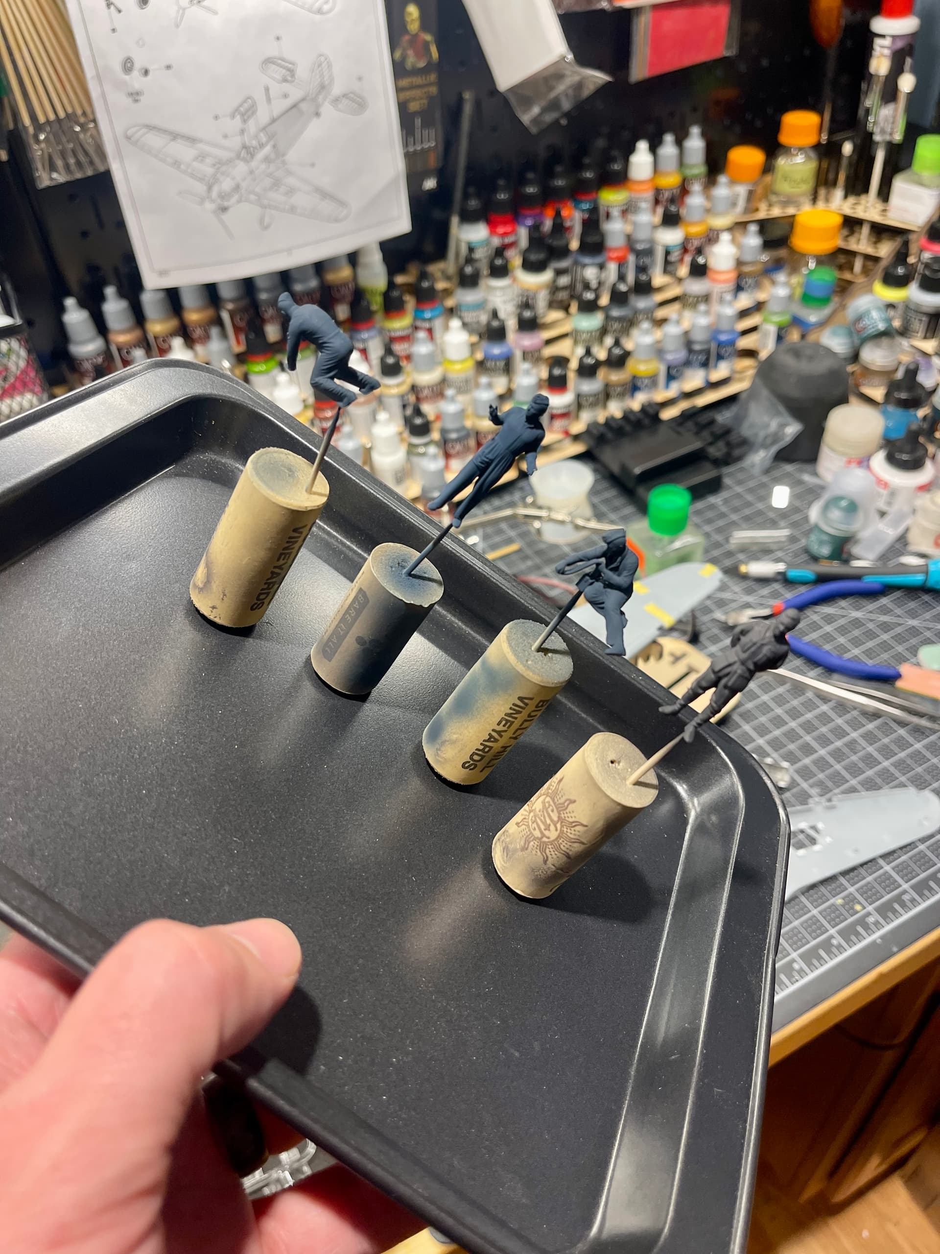

For a sturdier approach, sometimes I’ll drill a hole in the bottom of the figure, and glue in a bit of a paperclip or a sewing pin (with the head clipped off) and then stab that into an old wine cork or similar for painting. Then that same pin can later be used to pin it to the base/diorama/etc.

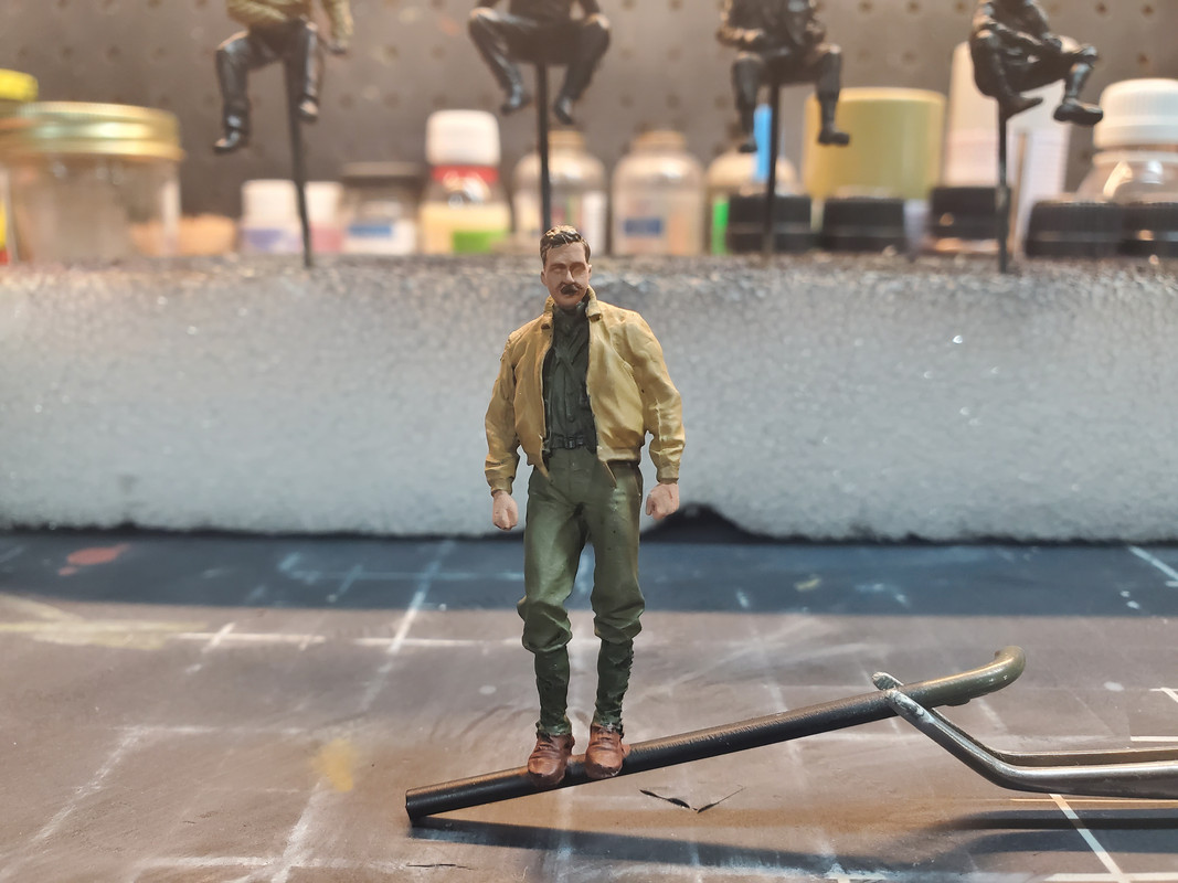

I also drill holes in the bottom of their foot or for sitting figures on their ass, “ouch”, I insert a tooth pick to use for holding,when I’m done,I break it off and sand it flat. The last figure, “Bible” I glued him to sprue as another option

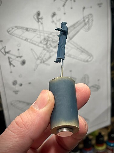

If you’re doing a bunch of them, or have a tendency to bump and/or drop things off your bench, like me, you can superglue a small magnet to the bottom of your holder, and then use metal trays to keep everything organized.

But I also do like Tojo does, and drill a small hole in the figure’s foot or butt and insert a pin, Then I stick this in a cork as a holder. I use white glue to fix the pin. Sometimes I leave the pin in, to attach to a base when finished.

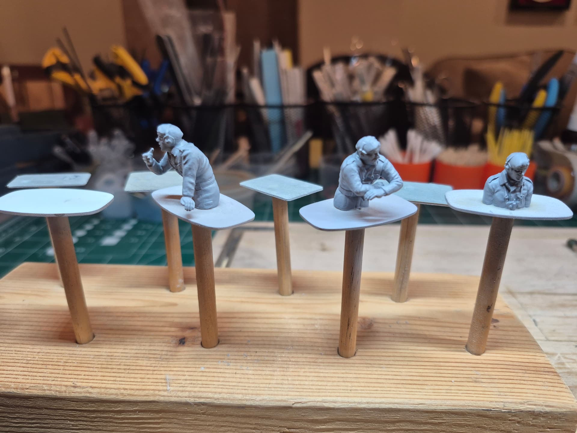

I use white glue or carpenter’s glue to temporarily mount figures on a styrene base that has been hot glued to a dowel. I drilled a couple rows of holes in a 2X4 to hold the mounted figures. The styrene bases/plates in the photo are the bases included in many figure kits, but you could as easily cut them from sheet styrene. Once painting is finished it is easy to just pop the figures off the base. The mounting glue usually stays on the base rather than on the figure, but it is easy enough to pick off the figure if necessary.

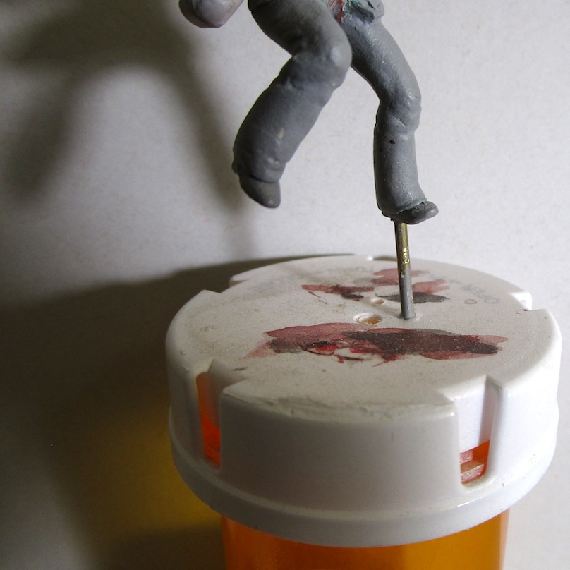

I use “recycled” handles for painting my figures. I use old prescription bottles. I will drill a hole in a spot that won’t be seen on the finished figure and put a pin in it to pin it to the handle. I use a little bit of super glue to attach the figure with the pin to the handle. I have tried using the poster putty with mixed results. Sometimes it held it just fine, other times they fell as soon as you moved them in a different angle. That’s why I switched to what I do now.
