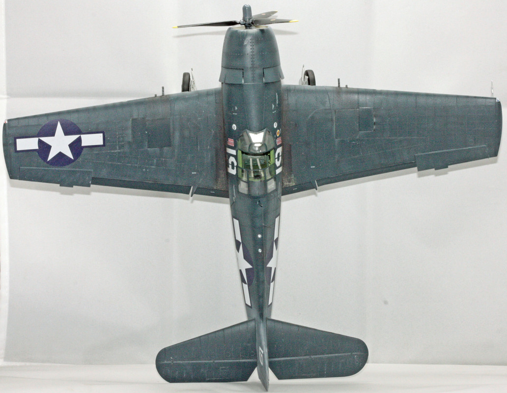

My primary paints came from the Vallejo box set for USN and Marine Corps aircraft 1940 - 1945. This Hellcat sported the tri-color camouflage scheme the Navy utilized in 1943 and into the first part of 1944 of insignia white, intermediate blue, and dark sea blue. Everything went just fine for those first two colors, but when I started painting the dark sea blue, I thought it looked rather more like a dark grey than a dark blue. I found an older bottle of US dark sea blue by a manufacturer called “The Color of Eagles” that looked more the part.
I mixed up black, grey, and brown to spray the distinctive exhaust stains, and augmented that with some Tamiya weathering compounds. I lathered the entire airframe with Flory wash, and I used some AK Interactive streaking grime across a lot of the underside. The entire top side got a bunch of ground-up pastels to give her the worn look that I was striving for.

The exhaust staining on the bottom is AK interactive? Is it applied with an airbrush or dragged with a brush like oils?

The primary exhaust staining is actually a custom mix I did of black, grey, and brown paint, applied with an airbrush. I augmented the exhaust staining with the AK Interactive streaking grime, mostly from vents and access panels, and all along the distinctive ribbing along the rear portion of the fuselage. That was applied with a brush and allowed to dry for about 10-15 minutes, then diluted and streaked with white mineral spirits.

Excellent work. The weathering is spot on.
