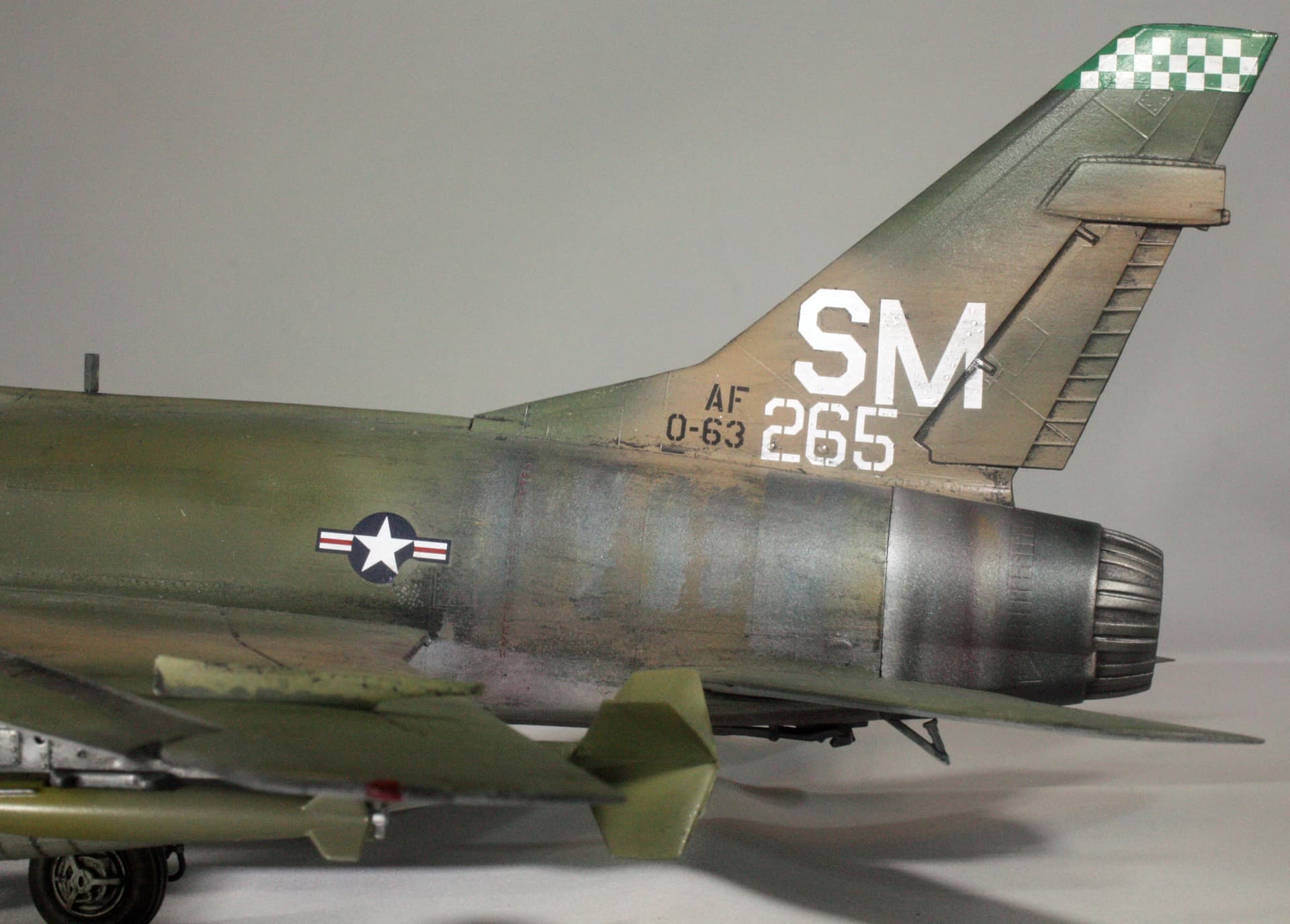

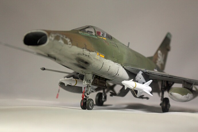

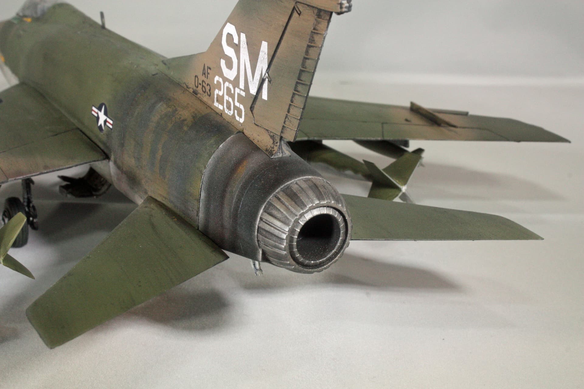

Here is a F-100 Super Saber I did a few years ago. The weathering was fairly light but based on photographs I’d found at the time. But then I did an F-102 Delta Dagger that was a Texas ANG bird that was pristine, with only a bit of engine heat weathering right around the exhaust cone.

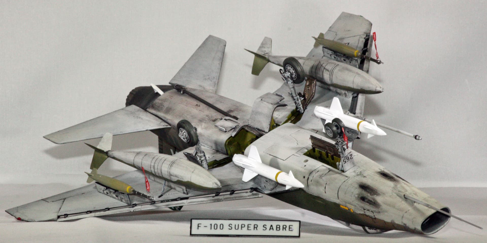

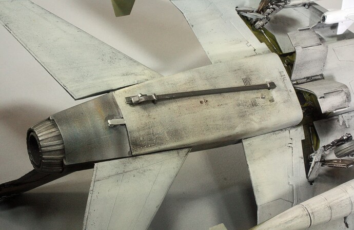

And the undersides - they seldom show on the photos and are also hard to see on the ground, and hard to get to - so they tend to get absolutely filthy:
This above is a mild example. Navy aircraft were sometimes a lot worse (that white paint!). When in doubt you can always take the Skyraider:
