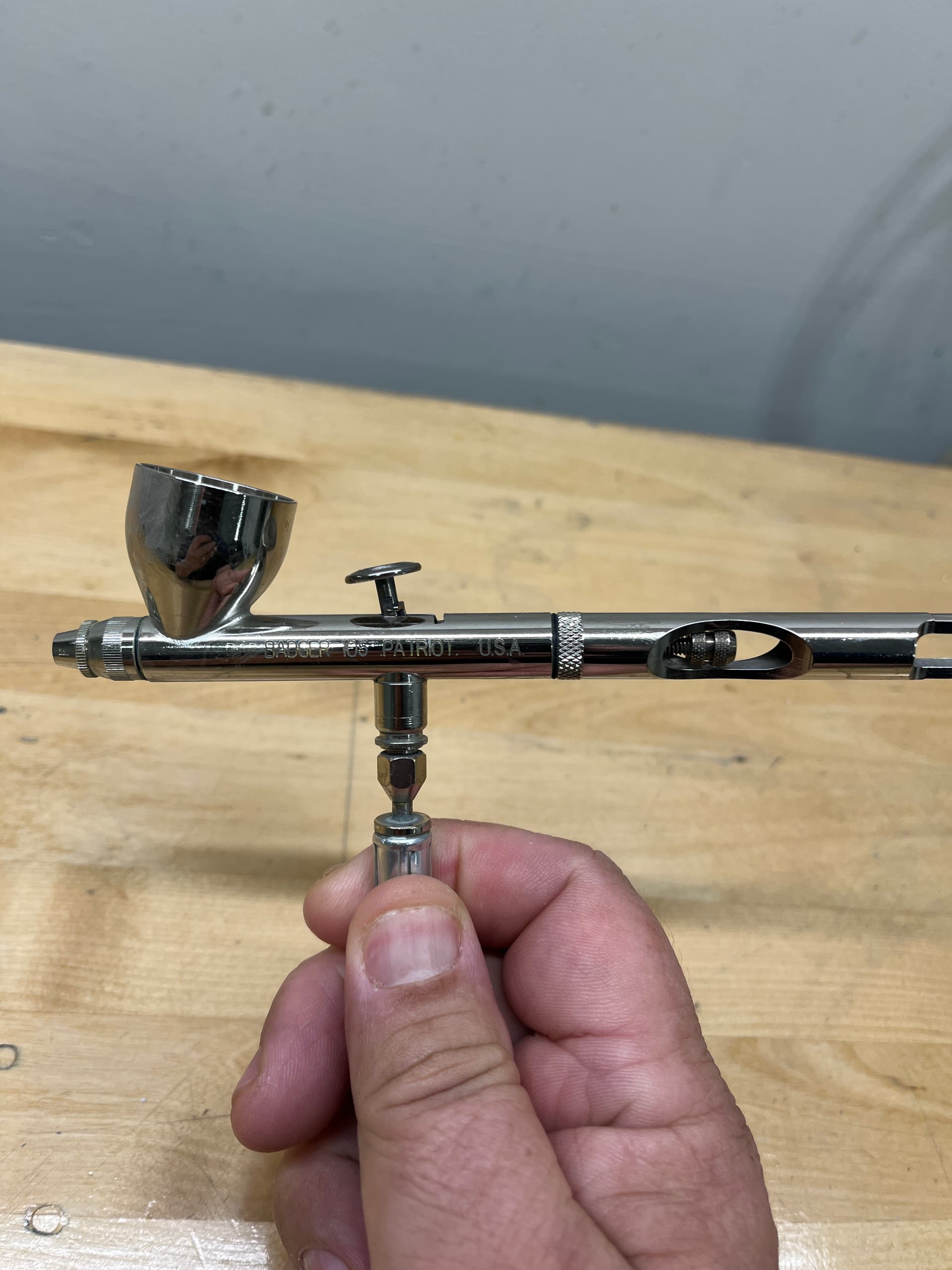

This is what I’ve been using from the beginning. Dual-action. I practiced a lot on plastic first. You can find out what pressures works best for you, and how you need to mix your paint to thinner ratios.
