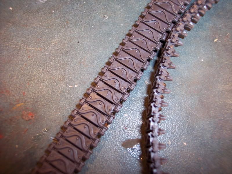

Step 1: You start by assembling the tracks, which are the T62 steel tread type, cast in glueable vinyl and split into two sections per side. Before anybody with an Italeri kit fresh in their mind goes screaming out of the room, let me say that these are probably the best vinyl tracks I’ve seen, and they are glueable with normal plastic cement. Once dry, I picked them up for inspection and couldn’t even find the seams. The instructions are a bit confusing here, and while they intend to show you to cut off the excess plastic sprue left over from the injection process, it could easily be misinterpreted as cutting off three links per run, which is something you do not want to do! On the other hand, the instructions are in very good English, a rarity for a foreign kit[;)]

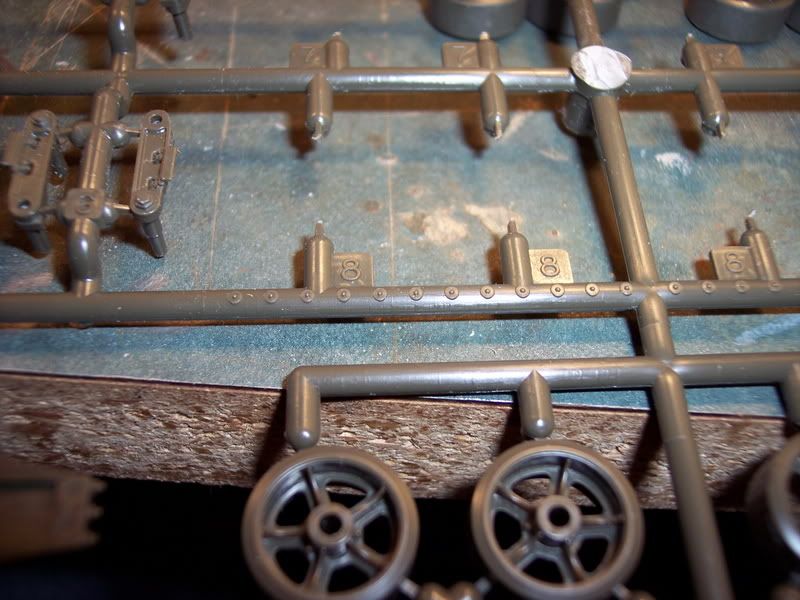

The one part of the suspension I really dislike are the rivets on the inside face of the road wheels. These are provided as little bumps molded directly to the sprue with no gate, which you must shave off and glue into place on the road wheels. The clincher is that there are 144 of them and there are no spares!!! I tried doing a few which I promptly lost/melted/glued to myself. My Firefly will just have to do without them! They would have been much better as PE parts, although then you’d have to file each one…
