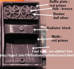

Ok here we go, without the PE zim, looked too cheesy, anyway first up is a picture of tank workshops resin radiators in place for dry fitting.
Next up we have both the radiators painted. I have to prime, then paint the upper hull before I can install it into the chassis for two reasons, if I painted it with the radiators glued too it, overspray would find its way down into them, and second they have to be installed before the the chassis and hull are glued because it would be very difficult to get them in otherwise.

Are you interested in knowing the correct colours for the radiators?
David
Why don’t you just TELL us the correct color of the radiators since we know you know?
Because I don’t like to criticise a model unless invited.
David
Sure, I see that. Maybe something like “Nice work so far. By the way, you might want to change the color of the radiator to X as my documentation says it was the most likely color.”
David
Davic-an admirble intention, but we’re all about critiquing and helping here.
Welcome to the fourms, and never hold back with what you know and see!
Tony–I believe that he radiators should be in primer red? Correct, David?
OK, here goes:
David
