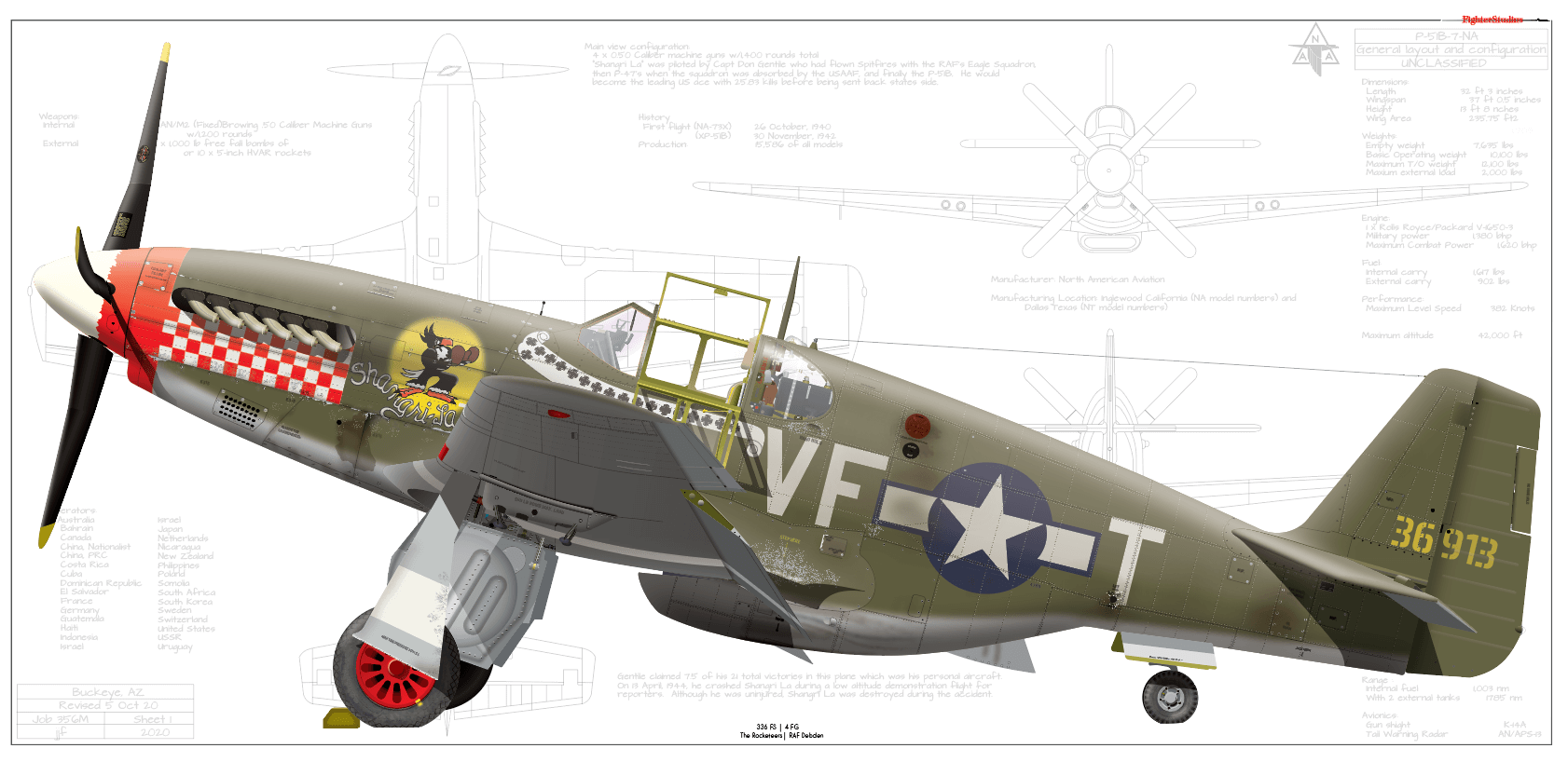

Question for those that know. What is the antenna configuration for the P-51B? I’ve seen at least 4 different options. Help!
It depends on the radio installation, different antenna configurations are possible. As usual to be totally accurate you have to go to photos because the same airplane might have different radio fits at different times. I would say I have never seen that depicted in the first photo.
Here are some links to a page on my website showing P-51 antenna fits.
SCR 522: http://goldeneramodel.com/Propplanes/p51/006p51.html.
General antenna chart: http://goldeneramodel.com/Propplanes/p51/007p51.html
SCR 274 N http://goldeneramodel.com/Propplanes/p51/005p51.html
Here is a wartime photo of VF T, Don Gentile’s airplane. SCR 274 N
!https://preview.redd.it/don-gentile-and-his-p-51-mustang-shangri-la-on-april-5th-v0-8lvwhh3z62e81.jpg?width=1100&format=pjpg&auto=webp&s=d80b6d0b4cb5312cfb7b17026b2862a5e2fee43a
Perfect Thank you.
I guess I should have looked at the box art before asking this question. Laugh…
