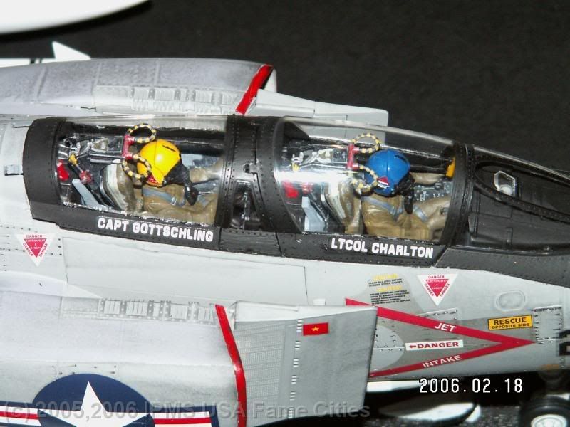

Cockpits fine out of the box, But i was told not vary accurate. Heres mine with the BB cockpit.
It has alot better detail than the kit parts. And 108 is still alittle pricy but if you dont have a LHS that has i guess thats your only choice.

this kit i would say is one of the best i put together,it seemed to me that the kit actually wanted to go together the best thing is the one peice fuselage but here is a pic of my cockpit i think it’s a great one
