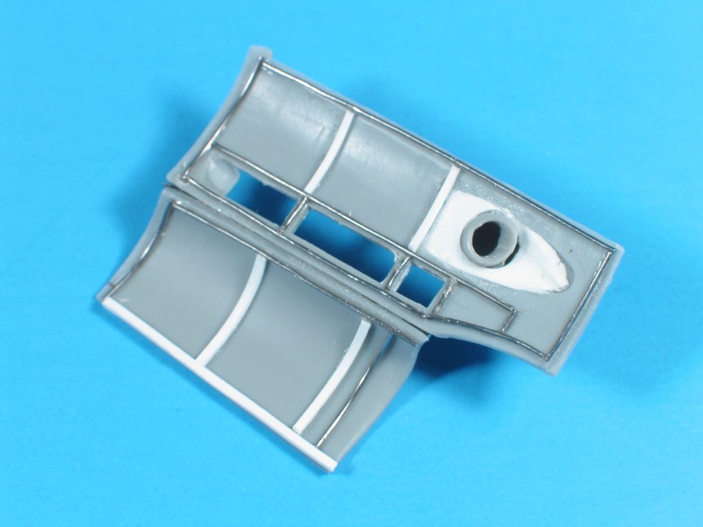

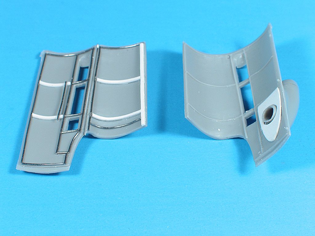

I added the Eduard photoetched parts for the wheel wells. They’re a little tricky.

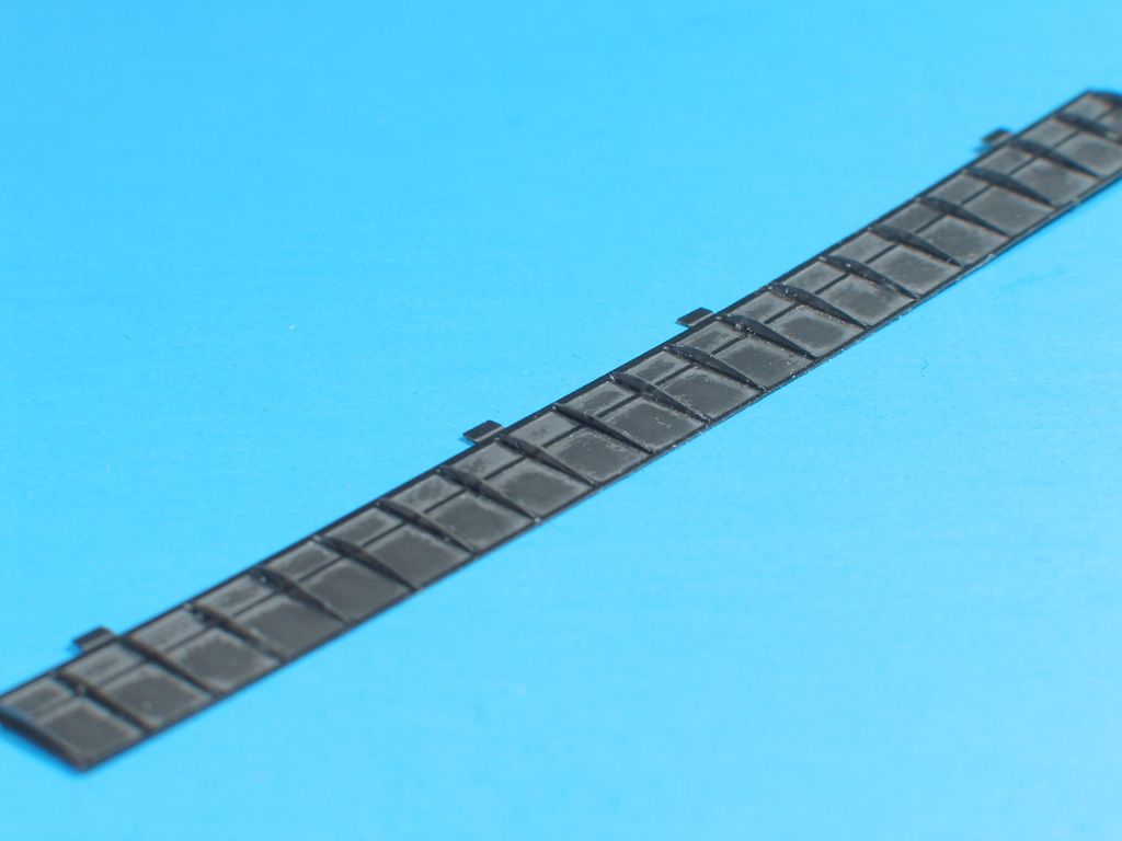

The PE flaps need a lot of care. There are 21 tiny ribs to install, and there are no spares.
I didn’t care for the ribs in the kit cowls, so I replaced them with styrene strips and solder. I also cut them apart at the hinge line that Trimaster/DML/Dragon missed.
I just finished the other cowl panel.

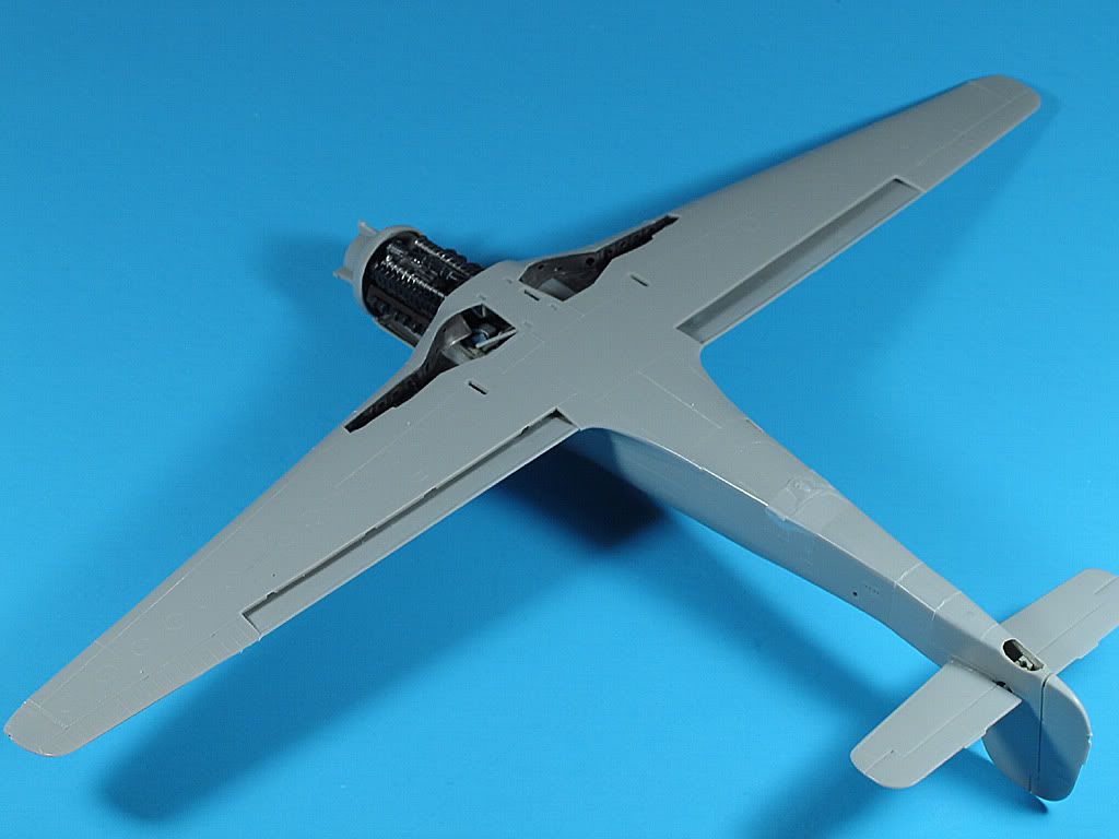

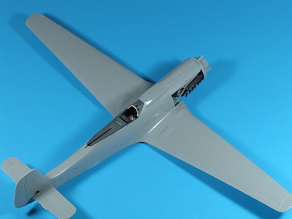

I wanted to make sure that the engine and wheel wells didn’t interfere with each other, so I test fitted the wings and fuselage. I don’t think there will be any problems here.

yardbird and TJ - when I get around to posting the detailing articles at my site, you’ll see that you can add a lot with minimal effort. All the detail in the cowl panels was added with a #11 blade, sheet styrene, solder, and CA. I just have to remember to stop while I’m working so I can take some pics of what I’m doing !

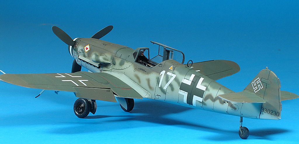

ron - I don’t have any 109s in the pile right now, but I built this 1/48 Hasegawa Bf 109K-4 a couple years ago, with Aires cockpit and AeroMaster markings.
