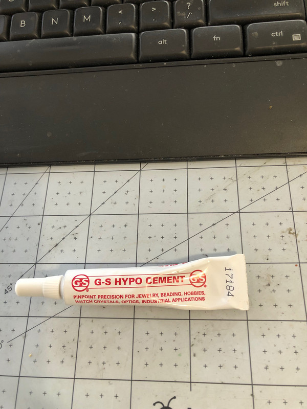

Ahoy Sharkbait. I would use G-S Hypo Cement first. Its solvent based and dries absolutely clear. I got this a while ago at Joann Fabric & Craft Store locally. Clear epoxy would be my 2nd choice.
