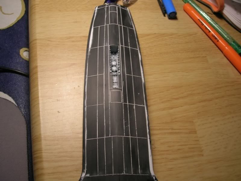

because if I binge on the scribing and filling at one time, I know I’ll have to purge it all back (the binge was figurative, but the purge is literal), I am going in sections.
you can see on the second to last pic that I sanded up to a horizontal line and stopped. I am using this method to control my styrene intake, as to not get high off of it and kill myself. I’ve calculated about 30 sections on the model so far, but it just grew to 32, because of the nose that I forgot about.
Lucien, do you remember that one part in the leading edges of the wings that have the zig-zaggish lines? those are like 10 sections alone lol. especially because the right bottom edge has a 1/16 gap AND a 1/4 inch step… so I’m gonna have to take care of the problem in 3D… 1/16 across and 1/4 up… AAAAHHHH
my plane is to slowly build up the putty while constantly rescribing the lines to make sure that my lines dont get lost
oh I forgot to add, it brings memories flooding back to see sanded styrene. the surface feels almost powdery, and I sheded a tear for my Revell Swift Patrol Boat which got crushed under a trash bag…(which just so happens to have taken 1/4 tube of Squadron white putty, but its still a good kit! [:D])
I just love the look of black styrene with white putty marks all over it and the black surface turning gray due to all the sanding because you know you are getting somewhere [:D]

scribing on the frontal bottom fuse is declared done, and the sanding is almost done. I have a sickly little step that I have to smooth out. how, I don’t know, but I’ll just have to tackle it and see what happens.

Looking GOOD, your doing a GREAT job on the lines, a LOT better then I would
and WTG Gedenke [tup]
Bud
Keep up the great work.
thanks a bunch guys! [:D]

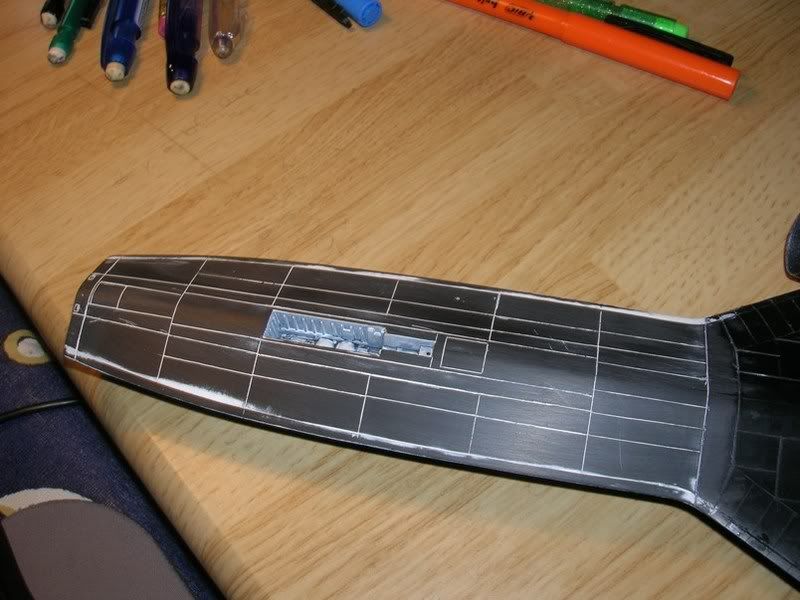

More progress today.
I sprayed the bottom forward fuse with white flat and sanded it all off. this method is employed to see all of the panel line mistakes and gaps that I forgot to fill.
although I did lay the white on a little thick and filled the panel lines, I found that the paint was easily scraped off.
