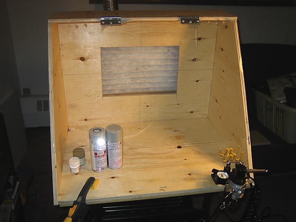

I used a 265CFM blower to cover off a 24" wide x 18" high x 18" max depth booth that I built from 1/2" plywood and some 1x8 pine board. I figure I would post some photos of the booth since, when searching online for plans, I never found decent photos of a booth.
Here we go:
http://www.chang-sang.com/photo/030905/front.jpg - here’s the front of the booth - plexiglass front on a swing hinge attached to a 6", in width, top.

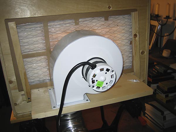

http://www.chang-sang.com/photo/030905/back1.jpg - here you can see how I mounted the blower to the back of the booth - the filter is held in place by just some scrap plywood screwed into the mounting pieces

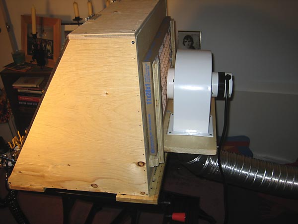

http://www.chang-sang.com/photo/030905/side.jpg - the basic shape of the side panels for the booth

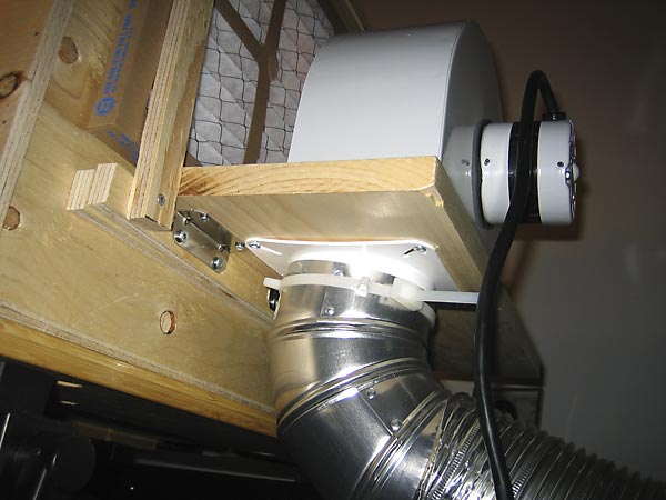

http://www.chang-sang.com/photo/030905/bottom.jpg - a bit of detail in how the blower exhausts to the aluminum exhaust tubing.

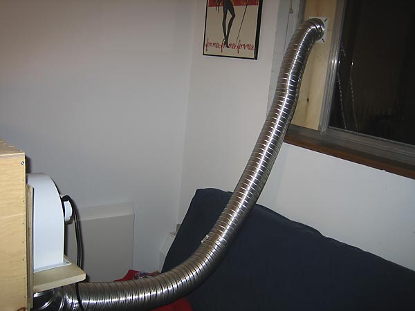

http://www.chang-sang.com/photo/030905/tube.jpg - finally the aluminum exhaust tubing is mounted to a plastic vent which exhausts out of the room.
