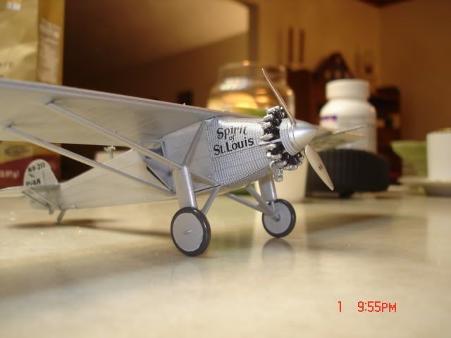

When I built mine, I painted the whole thing Tamiya Aluminum, then put the decals on the nose and painted the spinner alclad aluminum with chrome prop blades. Here’s a picture:
