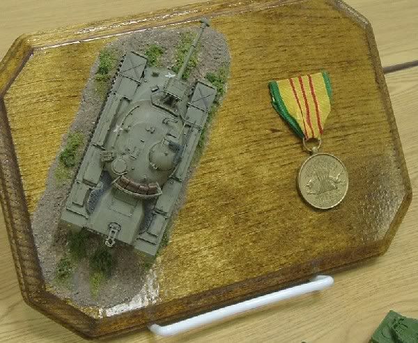

(4) wood glue and sand - yes but afterwards wash it with browns and tans and add spots of woodland scenics or some other brand of “ground foam”. Here is a link to one I did with that method:
http://img.photobucket.com/albums/v325/tarmac04/123004_047g.jpg
