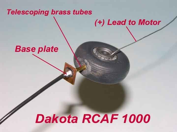

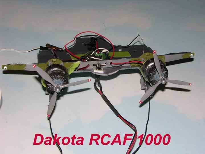

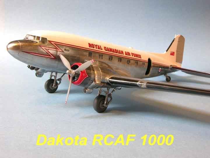

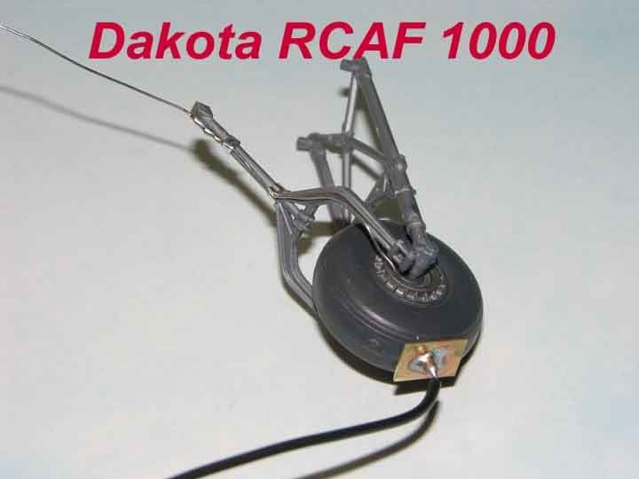

It has been said that a picture is worth a thousand words…so here’s a small book full of pics
This is my 3rd electric model with everything electrical being scratch-built. I also am putting the finishing touches to my Grumman AA1A “Alley Cat” but Dynamic Scale Models took care of the electronics on that one.
Barney
thats pretty impressive
