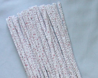

The most important thing is to keep it clean… Just keep it clean, don’t fudge on it. I treat mine royally after every use with a 3/16 stencil brush, a pipe cleaner, paper napkin and 91% alcohol (or laquer cleaner).
