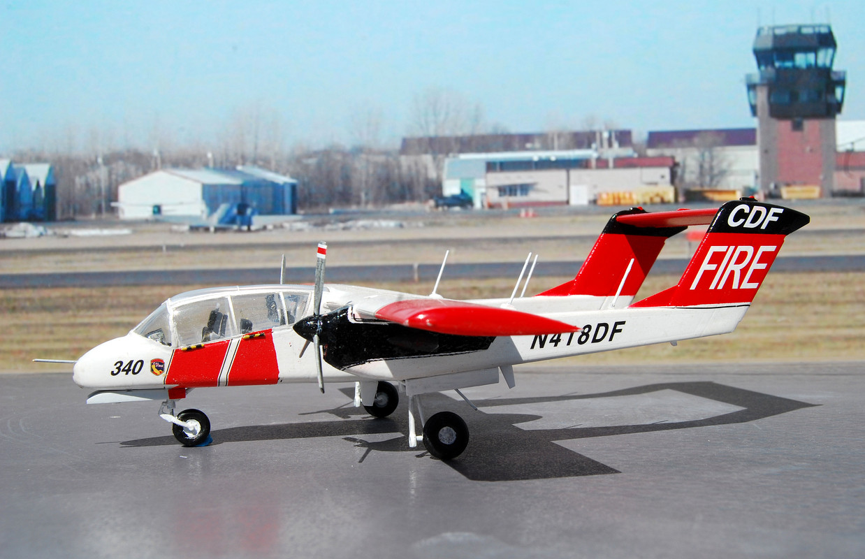

Oh, the irony! I like to shoot my finished models out in the sunlight, and I have some photo backdrops I have made at local airports. I used a mounting brack for the backdrops on a card table. I got tired of carrying out all the individual pieces of junk, so this spring as soon as the snow went away, I started building a portable photo studio to carry out into the back yard. I should finish it today- but, it snowed this morning- still snowing. And by the weather forecasts it will be around for a couple of days!
Okay, finished the photo bench. Here it is.
I used to carry out a card table, set it up, then bring out a bracket thing to hold the vertical backdrop upright, in all bringing out things in about four or five seperate trips. The new bench has both a vertical and horizontal section for the two backdrops (background and surface), and a storage area behind for backdrops. I got one image today before camera battery went dead,
