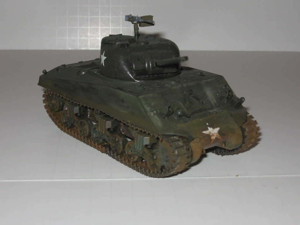

Hi all, this is my Sherman so far. The stowage will be added on soon. Criticism welcome!

Thnx for posting David. Two things I noticed: the tracks on the right side are on backwards – the “duckbills” are supposed to be on the outside, not facing towards the hull. Secondly, the seams on your roadwheels and idler are pretty apparent. It might be too late to attend to them on this model but it should be considered one of your “basics” in building. I recommend Kalmbach Publishing’s “How to Build Realistic Tanks and Artillery” – good tips and photos showing you what’s going on.
HTH, Roy
o-Rear tailights protective brackets missing
o-Pioneer tool stowage missing
o-Right hand Track on backwards
o-Seams on the Roadwheels/Idler
o-.50 mount is wrong type for that Cupola
o-Finish looks glossy in the photo.
all can be fixed with some work, dont give up by anymeans.
Hi, after looking at the Sherman for a while, I figured out I could fix the tracks, the .50 mount, the glossy finish, and the pioneer tool stowage is painted and ready to be glued on.
Thanks, David
