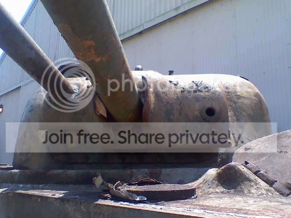

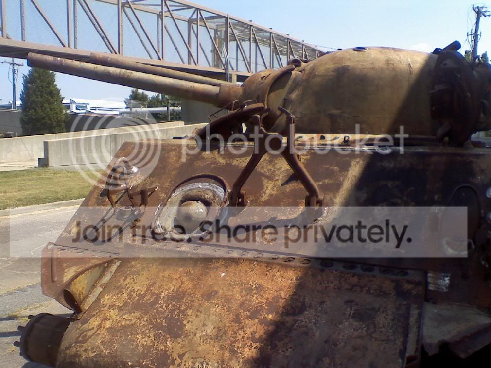

This should help some, this is a Sherman Flame-thrower tank, it can be found on the same side of the railroad tracks and right nest to OCS in Quantico…that is if they haven’t moved it. They had a M41 there in the summer also, but it was moved before I went home for winter break.
Hope this helps…
Very cool pics of that hulk Yg! That looks like a 75mm mounted co-axially with the flame gun and not the 105mm usually seen.
