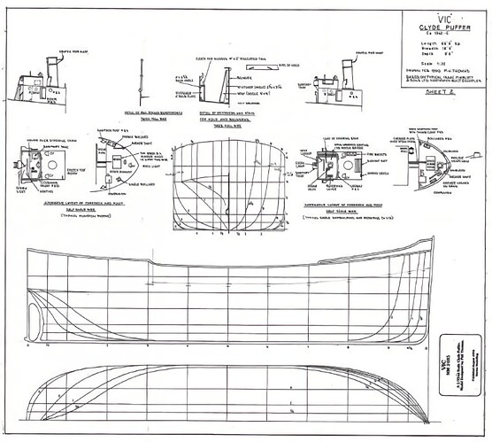

Finished drawings, ready to cut wood. Yes, like almost of my scratch ships I will be building it using the bread and butter method. I found some lovely Aspen, and the thickness matches the lift intervals.

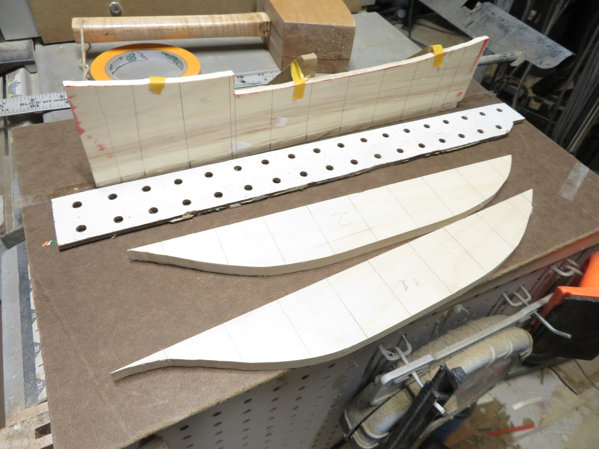

I will be adding a new idea- I will seperate the left and right lifs with a thin sheet cut to the centerline profile.

Here are the lines I am using
I was surprised at how many posts give puffer lines. I suspect the majority are Vital Spark..

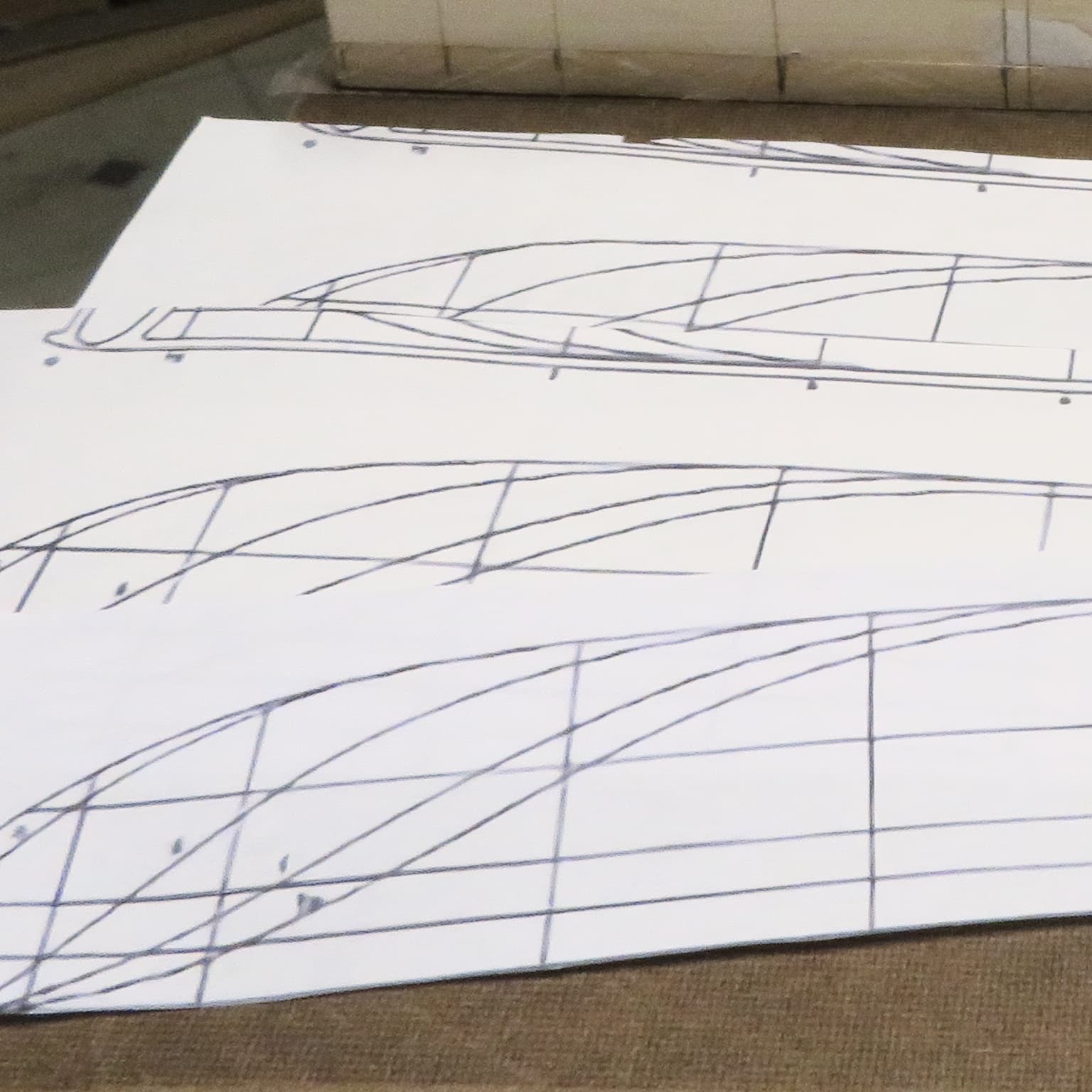

Got the profile up, and ready to lay out the lift patterns’
Ran out of printer paper, so went to the store and got some. Printed them all. Then when I went to glue the first one to the wood, I was out of rubber cement! Have to bike to conveniance store tt=o get that :roll_eyes:

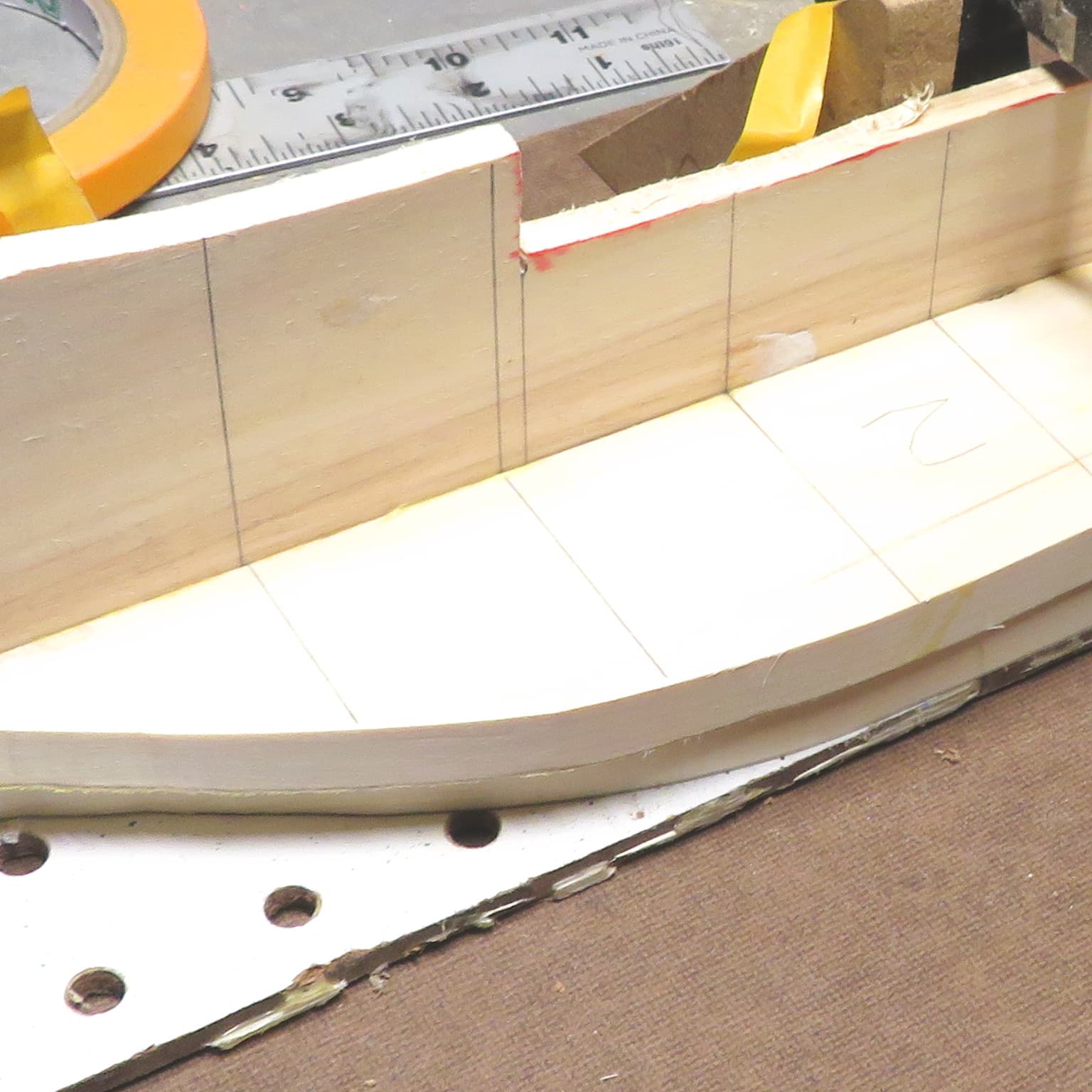

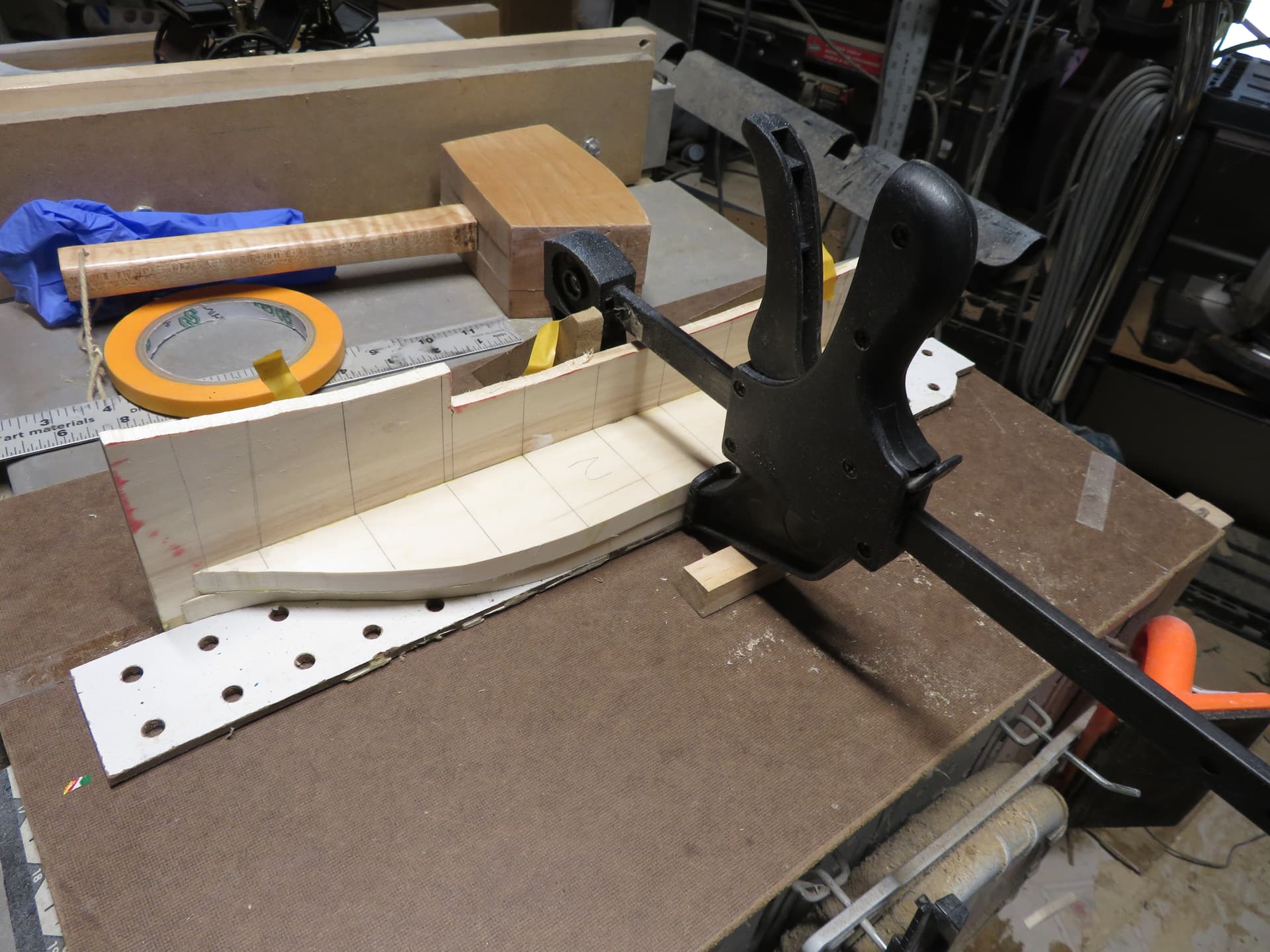

Further progress:
