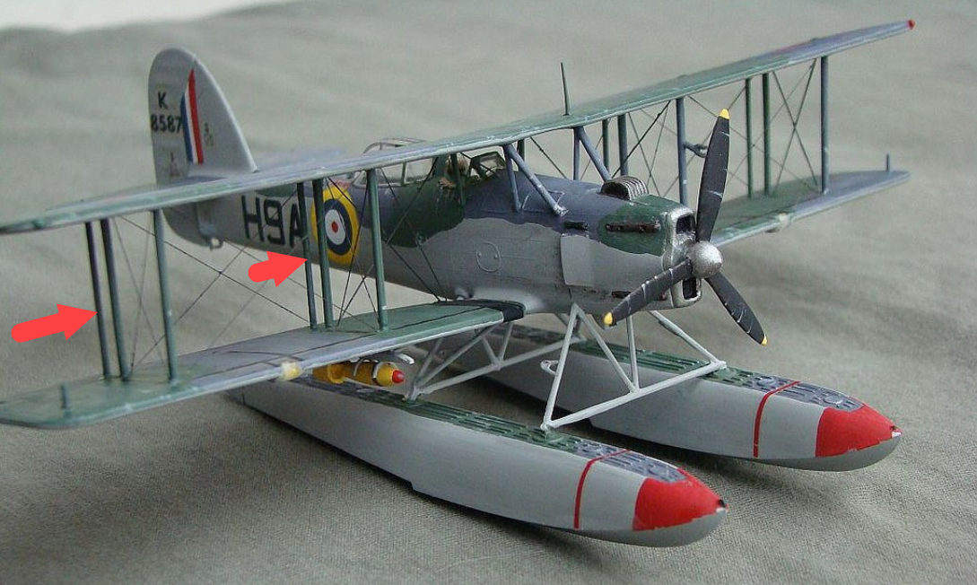

And you can see in this photo that the rod is not as thick as it is depicted on the model.
