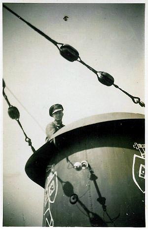

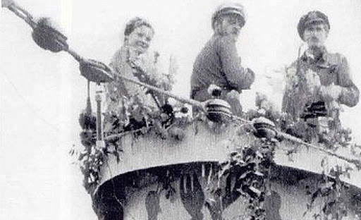

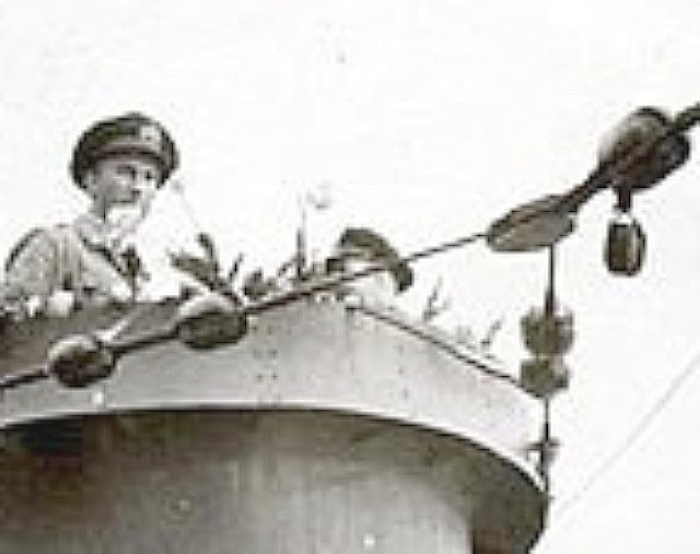

There are a couple nice close ups of the blocks here The look to be ceramic of glass.
Lot’s of detail pix can be found looking for U-995 / Laboe.

Rough estimate from looking through lots of pictures I’d say about 8" long maybe 5.5" dia, some of the boats look to have some a little smaller.
This is using images looking down on the con with crew present.
If need be you could contact the guy’s over on Subsim that visited the boat and took the pictures and ask them.

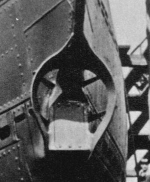

No new torpedo doors etc. Though I like that doohickey I see on the bow of the sub. What is it called? Is that the S-Geraet I see listed on the AMP PE list?

I am sure your model will turn out just fine with kit parts. Remember, the nice thing about plastic, it can always be fixed if broken. If the only thing you like out of the AMP kit is the S-Gert bow device you could try to scratch build it. Use and aluminum can for material, and made a pattern. If you mess up, throw it out and try again. If you decide to change youe mind and buy the kit…try http://www.freetimehobbies.com part#WEM7232. Just under $25 US. Most modifications for this boat can be made with aluminum cans, .01 sheet stock and putty. Most railing stock and cables from copper wire and thread. I have done a few models just rummaging through the basement.
A couple of pics you may need…
Covered S-Gert bow device, when the unit became outdated…
