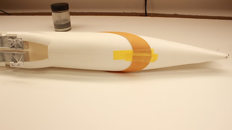

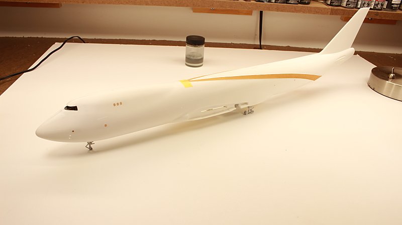

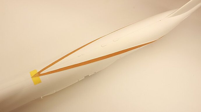

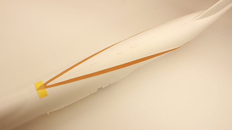

To get the paint layout on the fuselage correct, I made a color copy of the decals. I cut the yellow stripes out, and used them as a template. Once they were taped in place, I simply traced around them. This made it a lot easier to determine where each color would start and stop. I polished everything with Novus compound.Gave it a great shine.

Using the copies of the yellow strips made everything so much easier.

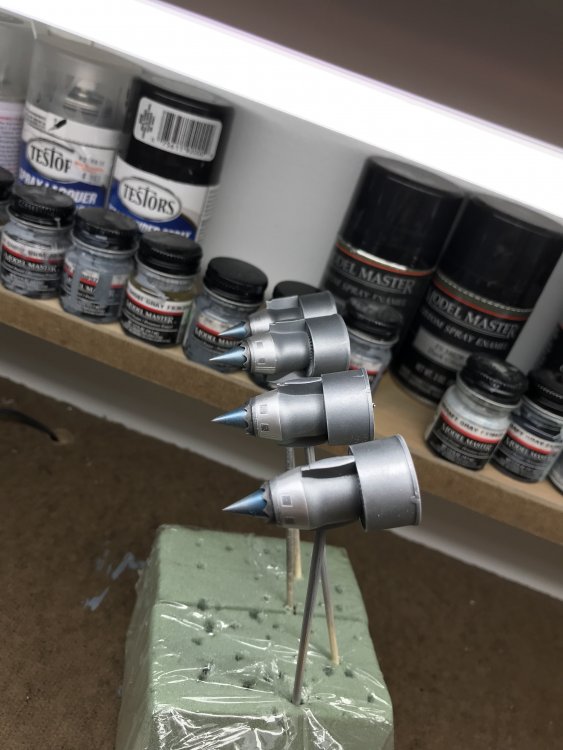

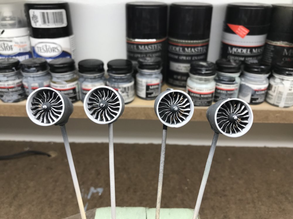

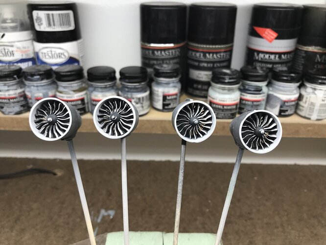

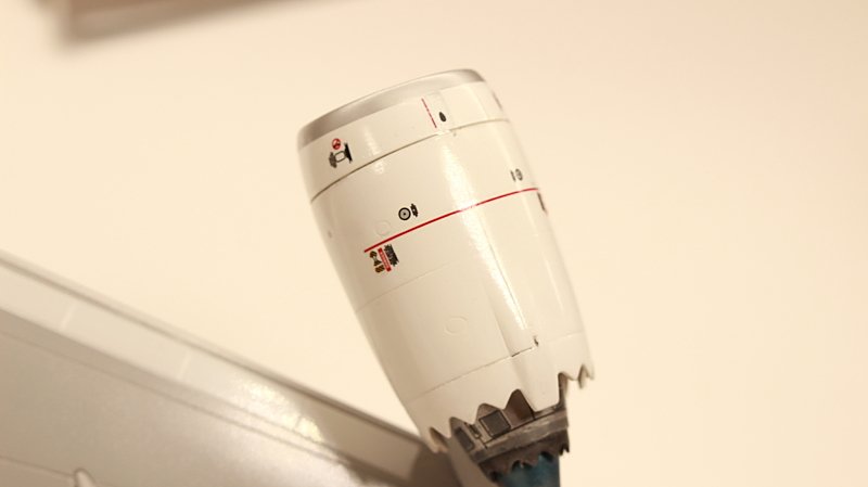

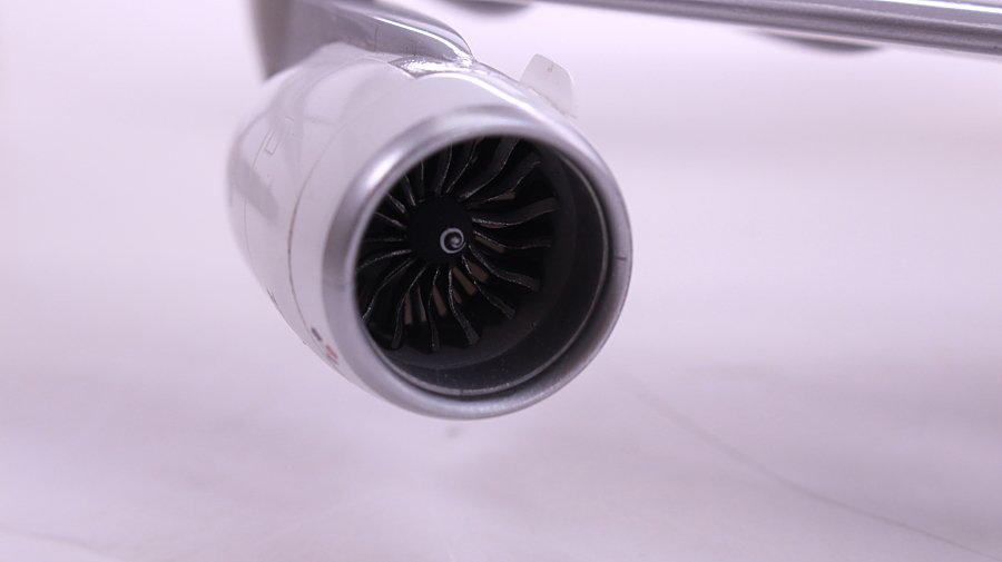

The engines were very nicely detailed

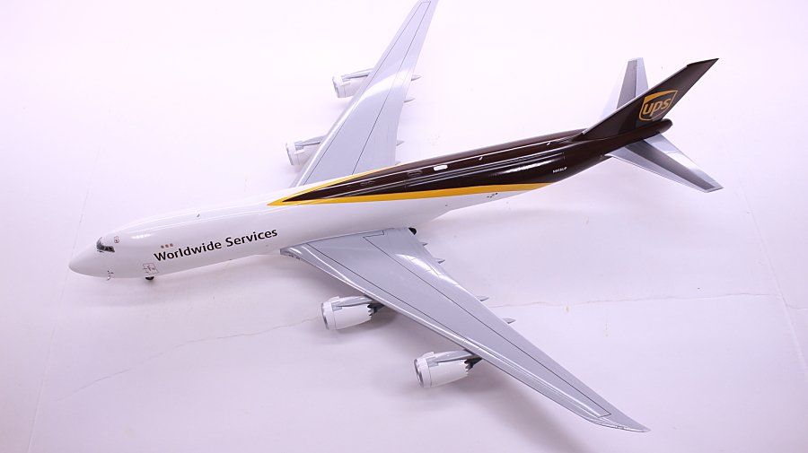

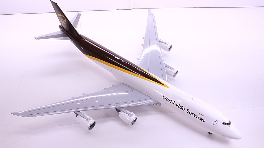

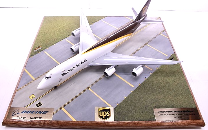

Finished model after polishing.

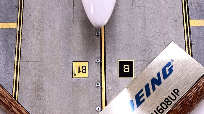

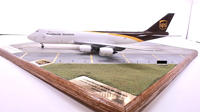

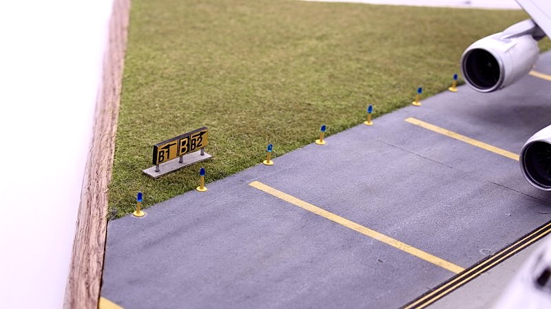

As for the base. I’ve been using sandpaper for years to simulate runways, taxiways, and even aircraft carrier decks. The smaller the scale, the finer the grit sandpaper used. In this case, 220 grit. For something in 1/32nd scale, use anything from 120-100 grit. My buddy gave me a layout of one of their taxiways. All of the taxiway lights are scratch
built. I had to recess lights next to the center line.

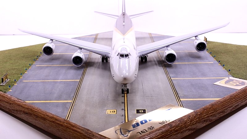

WOW, that came out great !! Would like to see an overall shot of the plane on the base.
Steve
Thanks Steve.

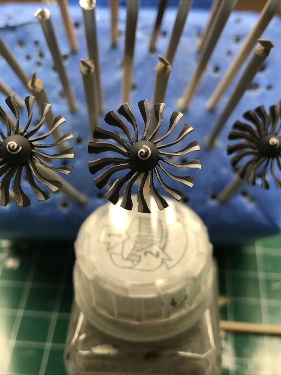

Absolutely and phenomenal build sir!! Your workmanship on this is impeccable. It’s a great kit and I see you’ve overcome the only bug-a-boo with the kit itself….the fan blades which can be distorted in the mold process.
