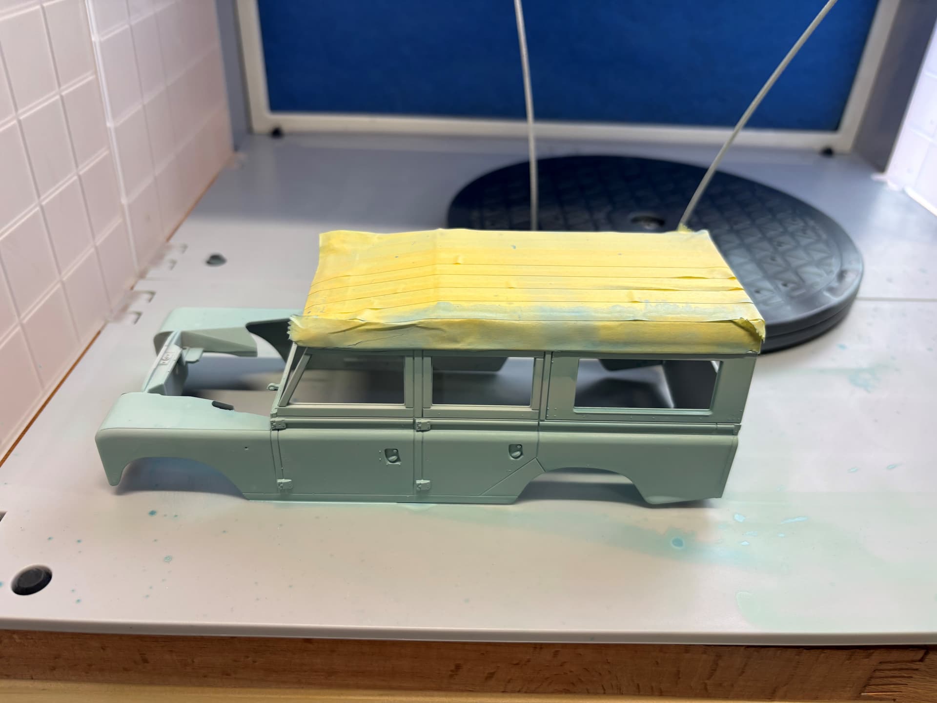

I have come to a stall with my Land rover
build and it is all because of the Airbrushing. I am trying to use the acrylic paint that came with the kit (Revell). My question is does anyone use Revell acrylic for airbrushing?, I am open to trying other paints however have not been able to match the colour well enough at this point. Photo attached, I think I am nearly there with the consistency however I am either too thick clogging up my airbrush or too thin to get a good coat. Any advice or suggestions are welcome.
