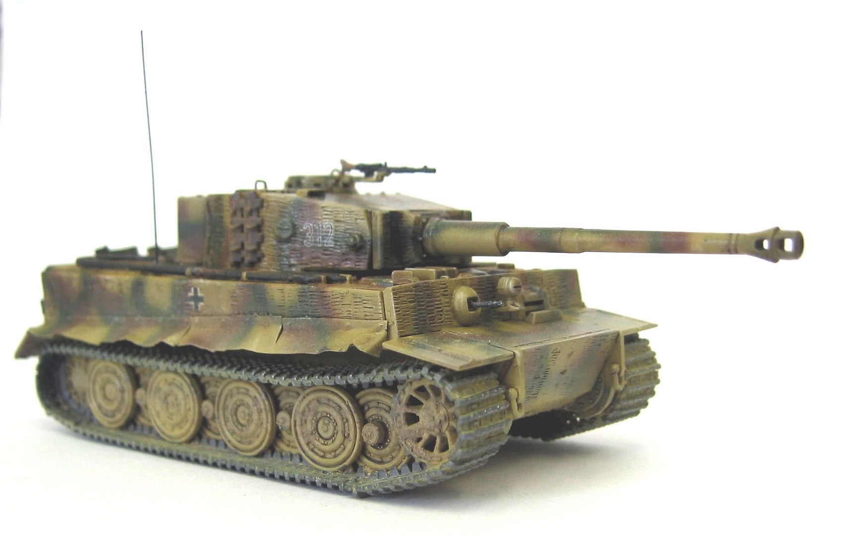

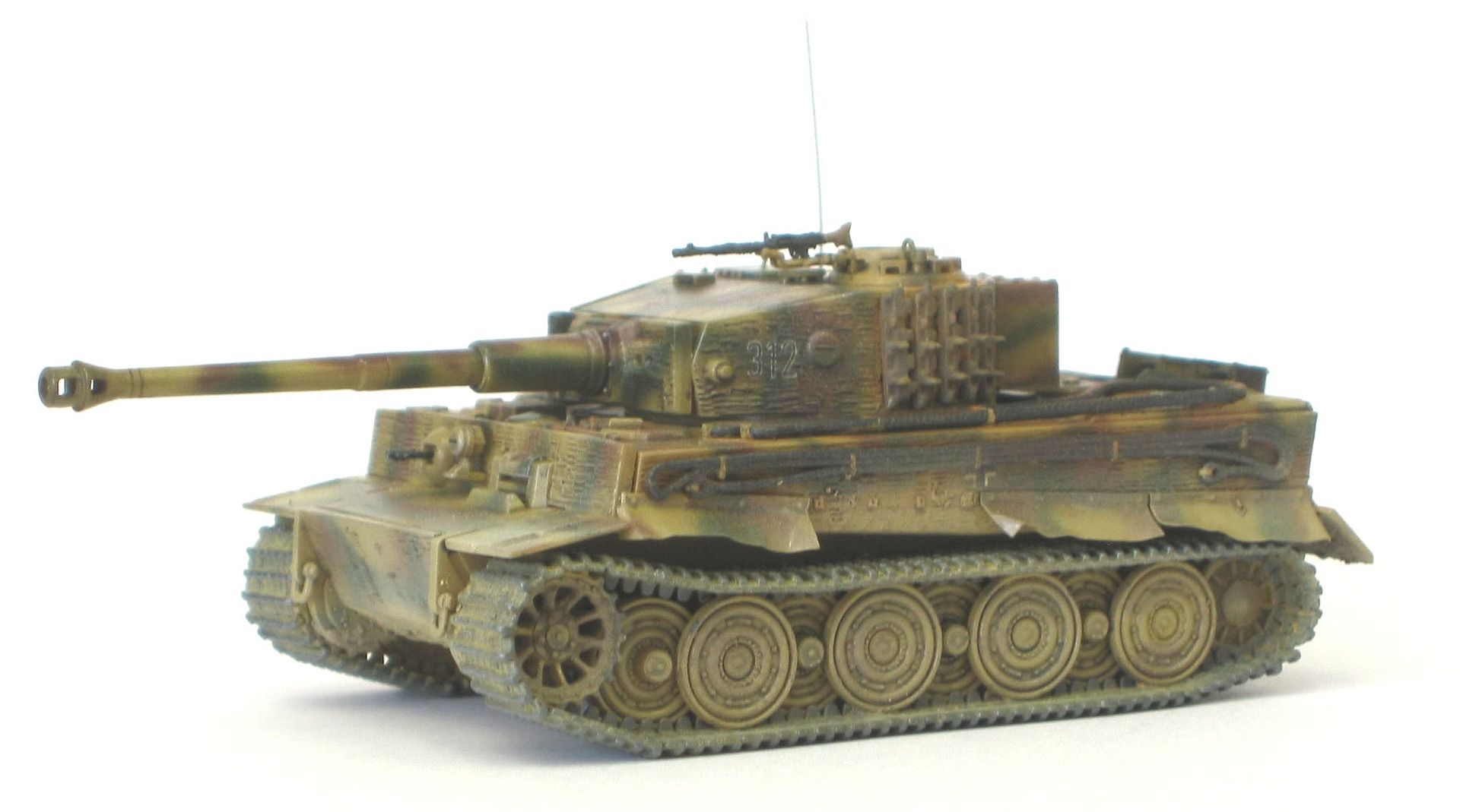

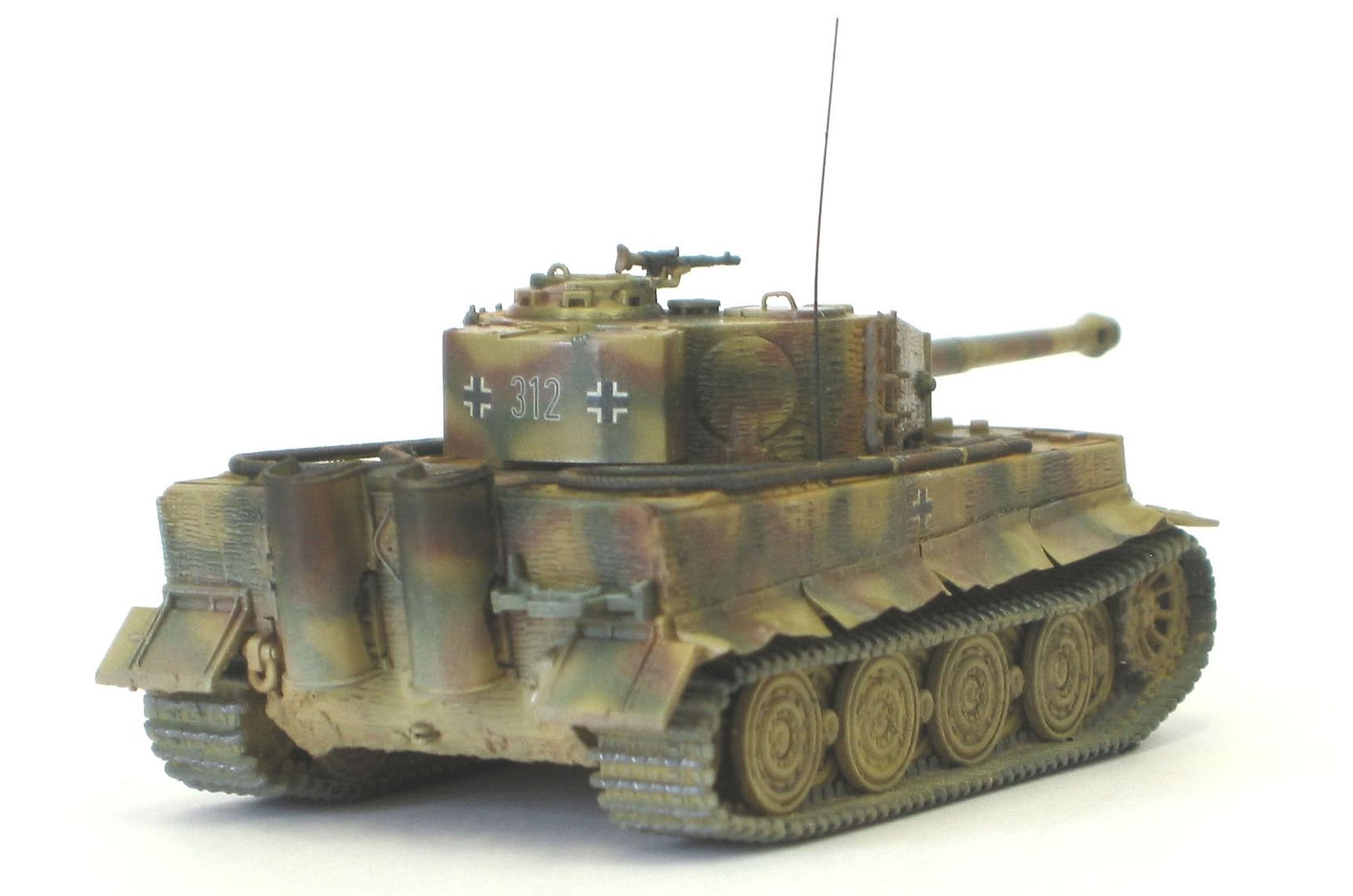

Here’s my Revell 1:72 Tiger I that I recently finished. I added zimmerite by painting it in liquid glue and pressing the zim in with a small screwdriver:
