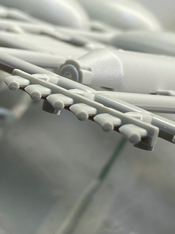

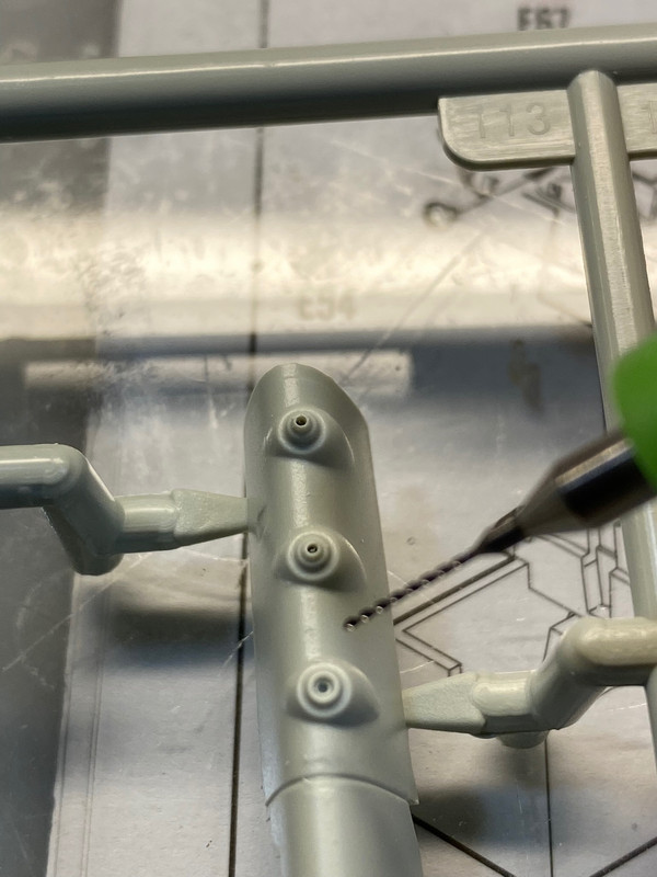

Drilled out the guns

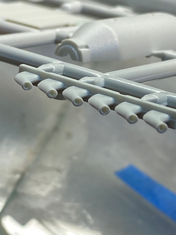

And the exhaust pipes, before
And after

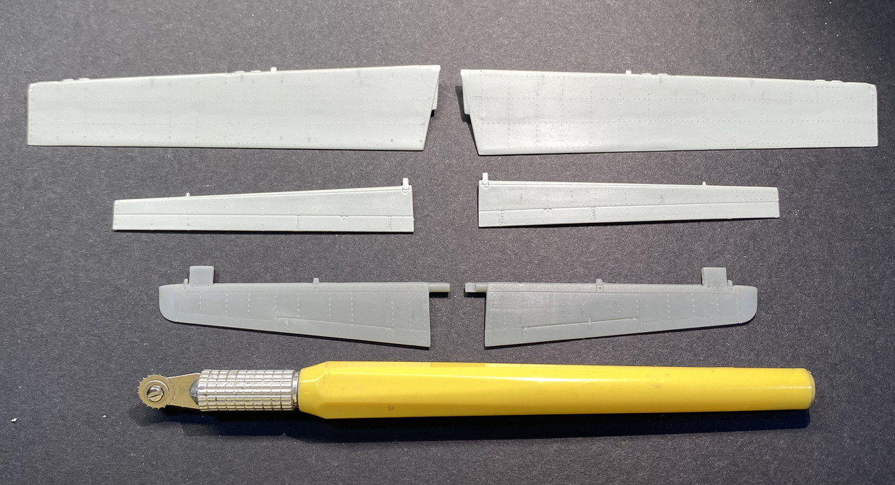

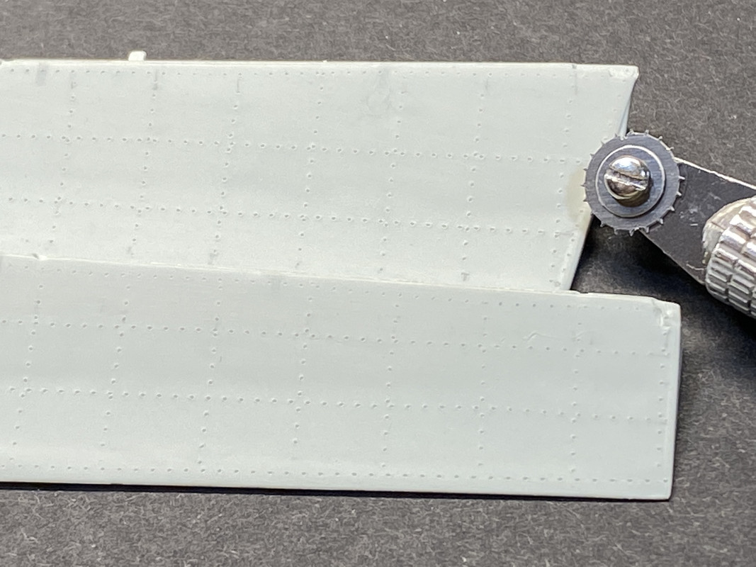

The flaps, ailerons and elevators are all missing the riveting so, out came the RB Riveter and spent a few hours roling the missing details. Just enough to busy up the metal skin.
The parts before detailing.
After rolling the riveter.
Topside completed, the bottoms will be next.
The rivets are subtle and hard to see in the pictures but will be more visible after paint and washes.

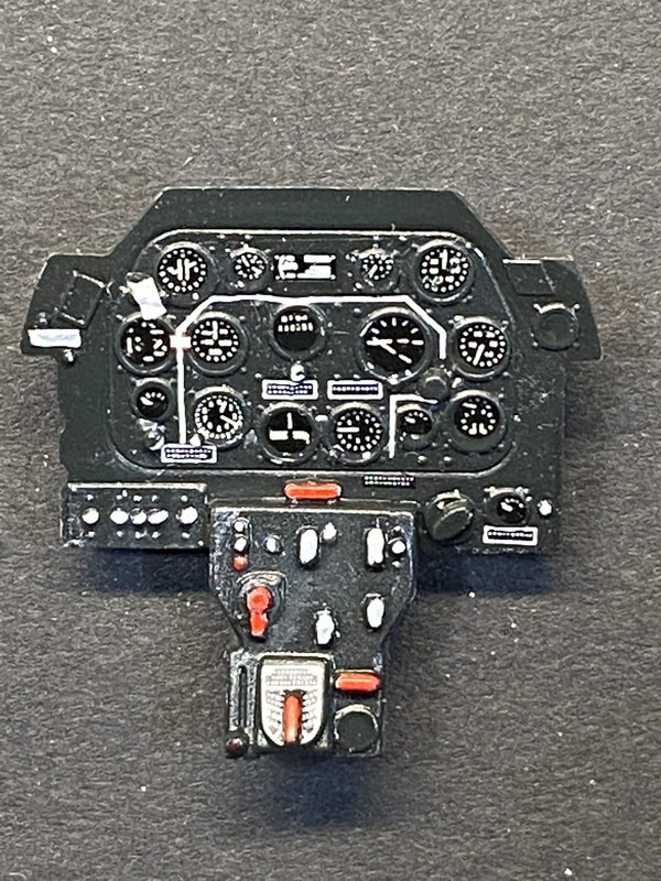

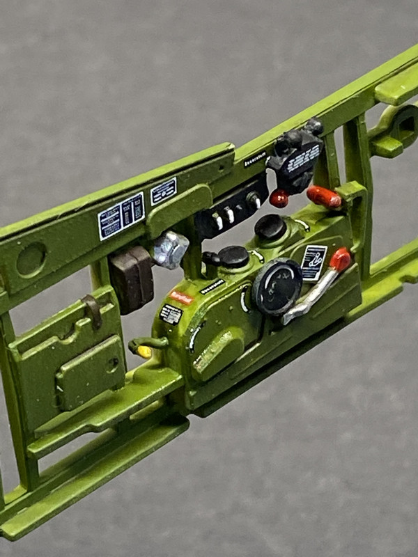

Got the pit completed. I used the kit decals and placards but were not enough so I dug into my spares for anything looking close to what the pony used. The wood floors were painted black and would show some foot traffic From use. I simulated this effect by dry brushing dark brown on the worn areas.
I wired up the radio battery.
The pit sides after paint and decals.

Used The kit decals for the instrument faces then added clear parts cement for the glass.
