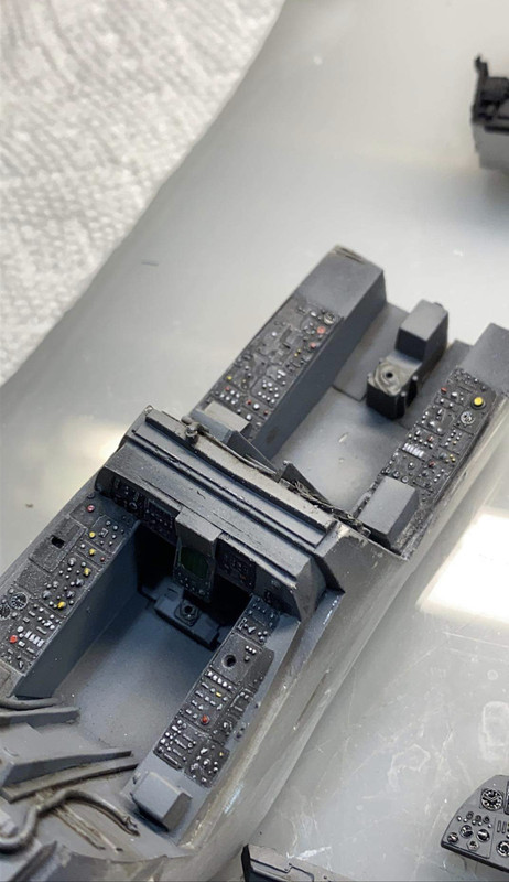

the IPs and pit sides were painted using enamels. Drops of Testors clear parts cement were used for the instrument glass.

The IP looks great - at first glance I thought they were those new Quinta Studio sets.
Thanks kd
The resin set is from Legend. Very well made and detailed. I’m presently working on the ejection seats now.

No matter what kind of aftermarket instrument panels I see, they’ll never impress me as much as a hand painted one. Top notch work PJ.
Thanks Chad!

Thanks cb. The Legend resin pit is quite nice. I had taken several pictures of the painting process but got accidentally deleted. I was able to find this one showing the nice molded side panel details.

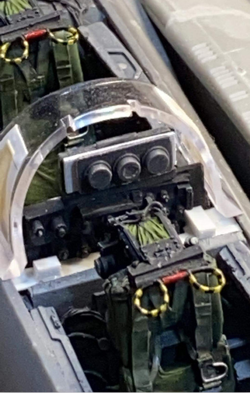

This is a commission build and the customer is not interested in the extra cost of super detailing the pit so the back of the rear panels got some free minor scratch work. Once painted black it will blend right in and will make it look busy enough. That area is screaming for tons of wiring.
Knox and Tojo thanks. Slowly making progress.
