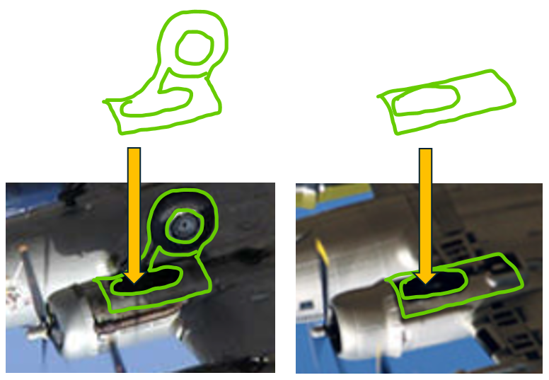

Hi E-van. At 1/72 I don’t think you’ll want to make gear that actually articulates: This would require simplification and over-sizing the component so they wouldn’t break, and it would be too much of a compromise for scale accuracy.
But I could envision a solution where you create two different removeable gear “modules” that can plug into the same opening under the engine nacelles, and be traded out as desired. It would require some scratch-building and a clever attachment method (magnets perhaps?). Here is a rough sketch of what I’m thinking of.

Thank you Rob! Yes, making it retractable might not be very practical, but I really like your idea, and I think it’s worth a try. I might design some 3D parts and have them printed. I’ll see, and I’ll keep you updated on my progress. Thanks a lot, and greetings from Argentina!
