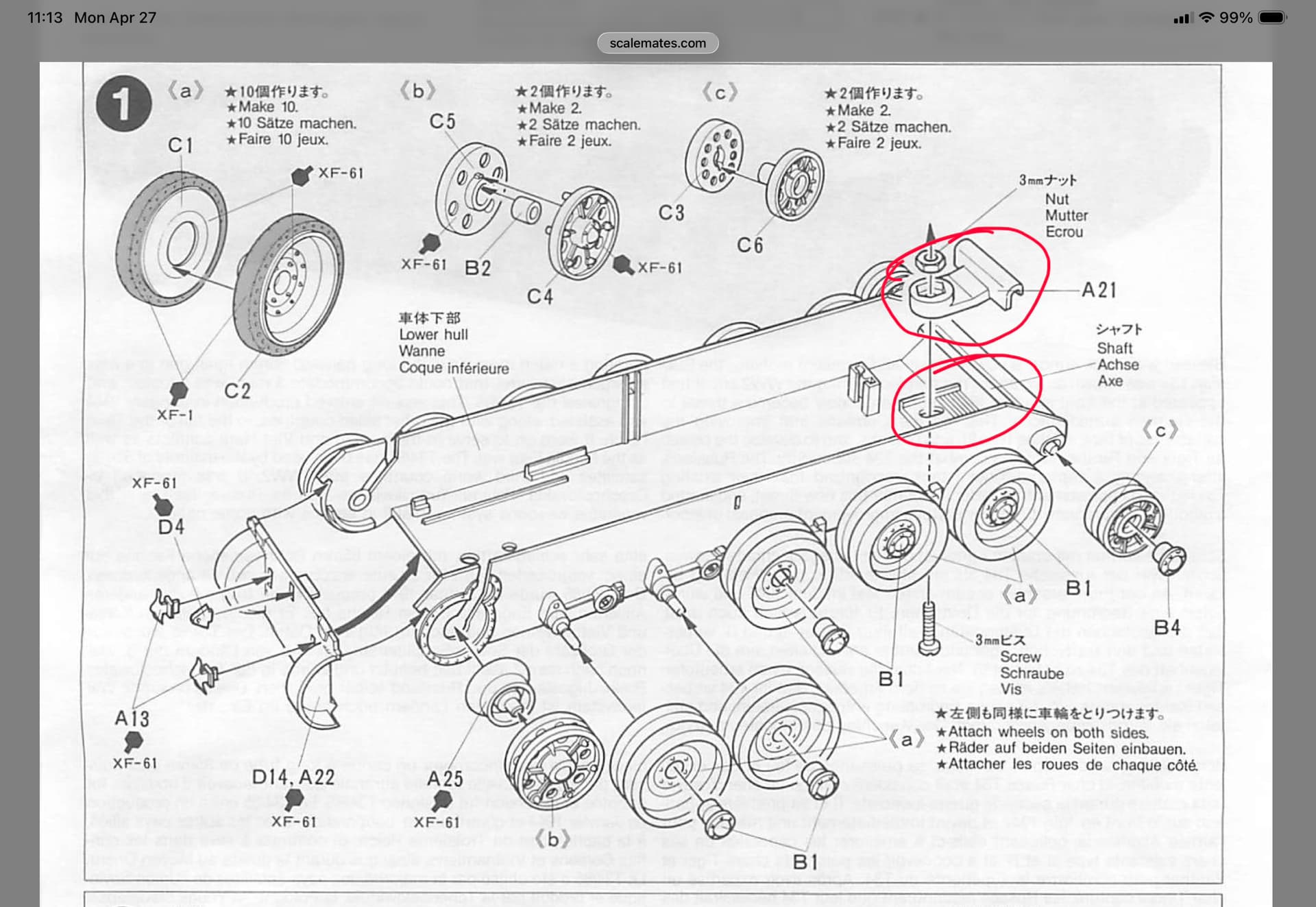

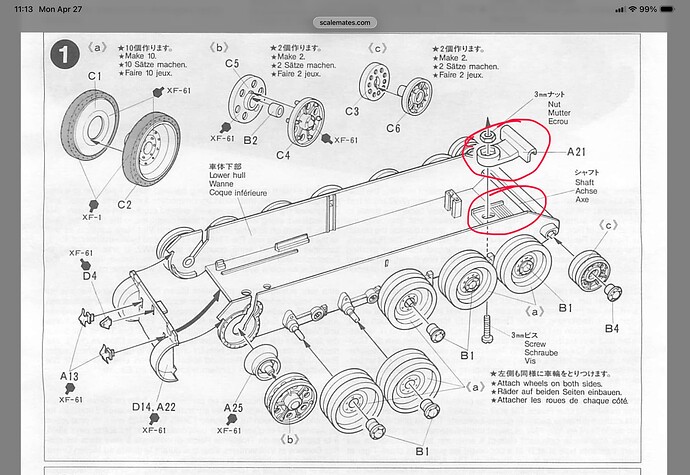

That being said, most of the Tamiya T-34s have an option to adjust the position of the drive axle slightly. This may allow enough slack to fit the kit tracks.
This option unfortunately doesn’t exist if you have one of the actual motorized kits.
