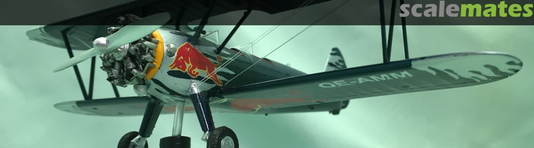

Jane got me this for Christmas. It’s the Revell version. She was looking for something she would like to see me build and was hoping I’d like it. Love it! We searched online together to find a paint scheme and both went nuts over the Red Bull Stearman.
Red Bull
Project ArtJane got me this for Christmas. She was looking for something she would like to see me build and was hoping I’d like it. Love it! We searched online together to find a paint scheme and both went nuts over the Red Bull Stearman.
Now that it’s under construction I’m wondering how to get that design on this little plane! Even in 1:48 it can’t be more than 6” long.

I have the kit of the cowled Stearman, and also intend to build it in Red Bull livery, but a different, older livery. I will be following your build. What do you intend for decals?
Don I’m debating whether to print my own decals or paint it using masks. I ordered the mask material but it’s so small I’m not sure about being able to cut them out cleanly. Any thoughts based on your experience?

I found some great side views at a ninety degree angle to the fuselage. Now, this is their older livery, with the red color, but it will work fine to make inkjet decals from. I am worried about wing decals, though. I have been doing inkjet decals for over ten years, so the thought of doing it doesn’t bother me, but I need to find the art work to use. I can do pretty good things with my photo editor, but it is not total magic. And since that red livery is an older one, continued google image searches may not yield any more images.
They have an rc plane with all the decals on it. Grabbed these shots for the wing decals. Do you think they will work?

Do you intend to do the flames by decal or by painting? The silver color may be hard to do with decals unless you have an Alps printer and the proper cartridge.
hmmmm, I’ve never done decals before so didn’t know it would be that hard. Fortunately it’s a bit of a flat silver, but that may not help in the printing process i guess? I had picked up some decal paper and the spray for it to set them on the paper. I haven’t tried it yet and was thinking I’d do it here. I’ll do some test prints of course on plain paper to see what i get. i have to find my photoshop disk now and see if it will install. On windoews 10. I hope so because i hate photoshops new monthly online plan.
any suggestions for a free program that i can use to do the artwork?
There are only two that I am familiar with for free are the Paint that comes with Windows, and GIMP. Paint is quite basic- not sure if it is good enough for your job. GIMP is free, but the help stuff is really basic, and it is not the easiest to use. However, if you have used Photoshop you may be okay with it, or there is a book on GIMP.
I use Corel’s Paint Shop Pro. It is very powerful, better than GIMP, and much cheaper than Photoshop, typically around seventy to eighty bucks (it is frequently on sale). Adobe has a cheaper alternative, for about the same price as PSP, Photoshop Elements. Not quite as powerful as PSP, but close.
