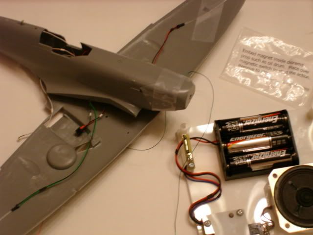

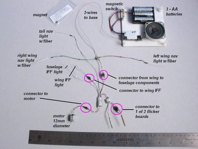

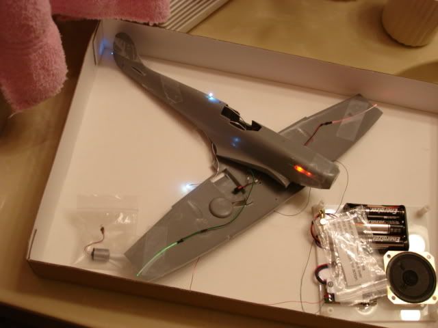

Well, so far I have not done any of the subassembly painting, but I have gone ahead and drilled out the navigation light for the tail, the wingtips, the IFF ( dorsal and ventral) , and the rear face of the recessed exhaust bank. I test fitted the electronics and so far so good. The small motor in the bottom left corner is the one which will eventually turn the prop.I taped the fuselage halves together to get an idea how this will work. Eventually I will have to make my own exhausts as no one makes a 1:32 exhaust for the spitfire ( at least moskit doesn’t). I may take some thin brass sheet and my etchmate and make my own. I left the top wing halves off as the cannon are fragile and don’t want to pop them off. The sound board will eventually be mounted under a display base and its magnetic switch tripped by an oil drum or some other such prop. The electronics break down into subassemblies to make installation easier. The motor controller and exhaust come as seperable units, as does the wingtip navigation and IFF lights. More to follow as I find time…

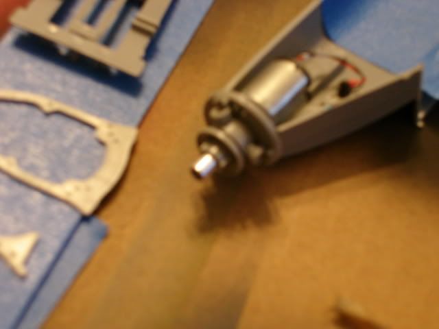

Well, so far, so good. I went to test mount the spinner and it wobbled horribly, so I reinforced it at the axis by sleeving the shaft with 5/32 ID aluminum tubing.This slid perfectly over the supplied shaft from DSM. This “should” eliminate most of the wobble. The real challenge is going to be mounting the individual blades into the spinner and having them set at the correct angle and pitch so that it doesn’t vibrate to pieces on startup. The motor has already been superglued inside one of the fuselage halves. The background pieces are all of the cockpit details prior to airbrushing , detailing and weathering. With any luck I will be able to fabricate suitable exhausts, as I opted for flickering exhaust leds and no one ( not even moskit) makes an aftermarket set in metal for a 1/32 scale Spit. More pics to follow…
