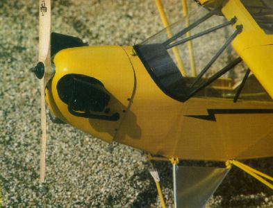

Cub Yellow is a bit oranger than insignia yellow. It’s always a problem to match. For my RC models I had a can of it custom mixed in acrylic enamel from a Randolph formula. You could start with the Tamiya Deep Yellow, I think Model Master enamel might also come in that color and spray a sample on some scrap plastic and see how it looks first. Doing it over a white base would be good. It may need some lightening with chrome yellow , but after a coat of Future it may look OK.
Sometimes I have seen it in R/C stores in spray cans, but I haven’t used those. It has been a common subject in RC circles. Here is an old photo of one of my R/C models, 70 inch span.
Thanks for the responses guys. John, while I am by no means color blind, I can’t look at a color and say, “Oh that just needs a drop of red.” On the rare occasion I can. All I needs is a good starting point. Based on your comments I took some insignia yellow added a drop of int’l orange and lighted it with a touch of white and it looks real good to me.
