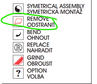

Yes, you will need to make the surface that you’re applying the PE to flat. you can scrape it off. You don’t to sand smooth, just a flat surface. It’s going to be covered anyway. the PE instructions will tell you what detail that needs to be removed.
I circled the remove and not the grind. But you get the picture. (hopefully)

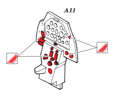

Unfortunately the pictorial instructions that came with my detail up set do not specify items that need to be removed. It does point out items that need to be bent or drilled though.
