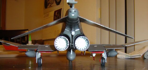

this is the Revell 1/32 RF-4C done in the markings of the Reno ANG 65-870 (my dads airframe). The decals are Airdocs, CAM, and kit decals. RBF flags are Eduard and lead foil, cockpit is scratch built and Wauldron insturment bezels, engine details are scratch, so are wheel well details, so are camera bays. Enough talk, here are the pics:

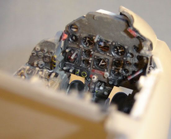

Outstanding Phantom! Post pics of the cockpit please, I’d really like to see the details.
Where did you get the instrument bezels? I’ve got an F-4 1/48 in the closet I’d like to add bezels to.

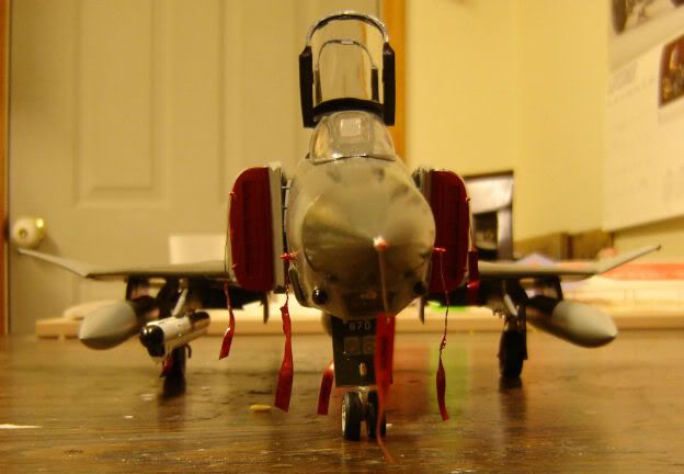

Cool Build, but I have to ask, what did you use for the red tags ?

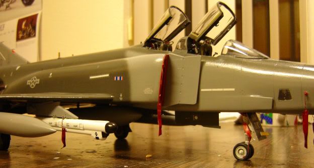

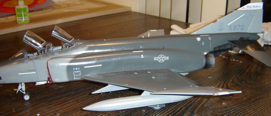

I like the Phantoms and you did a great job on it. I like the red tags and inlet covers. One comments though: it would be more realistic with a flat clear coat.
Very nice Phantom Jim. Maybe a tad too Glossy, but looks great.
Regards, Rick
Actually, the paint was a semi gloss. Some aircraft were even polished to a high gloss sheen such as the comanders aircraft.

Thanks all, I started this build in May, so it has been a long one. The insturment bezels were bought from Roll Models, I think they have an add that shows up in FSM or up on the website here.They have them in 1/24 down to 1/48 scale in several different sets. They also sell insturments, and plackards. You will need one of their punch sets though. I have their large punch set, and use it all the time. The RBF flags are lead foil from verlinden, with beading wire stringers run through a hole I put in with a sewing needle. Thanks for confirming what I remember from my dads aiorplane Berney, I thought it was semigloss. The pics I posted were a little shinney (I am a better modeler than photographer).

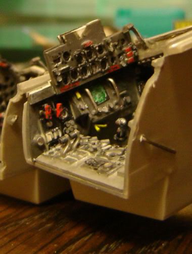

Most of everything was scratchbuilt here, except the little panel to the right of the front panel. I sanded all the detail off and started with a bare tub and built up from there. This is my first scratchbuilt pit, so I am proud of it. it has a few inacuracies, but is closer than the kit.
As for how it went together, not bad, their was alot of stuff added to make it more acurate, and detailed. The wheels are backwards, if you put em on the way its designed, their on backwards, the outside faces in so you have to drill and put them on right.

Wow, awesome Phantom. Remind me not to post mine up when I’m done.
BTW - That cockpit is amazing. I’ll have to commission you to make one for me.[:D]
