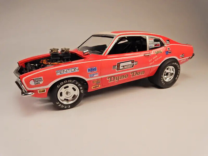

That’s what I’ve done more than a few times and it works just great. These are decals that I applied over the tire, flat coated over them and dry brushed ground up brown & black pastel over the decals for a worn/ dirtied look

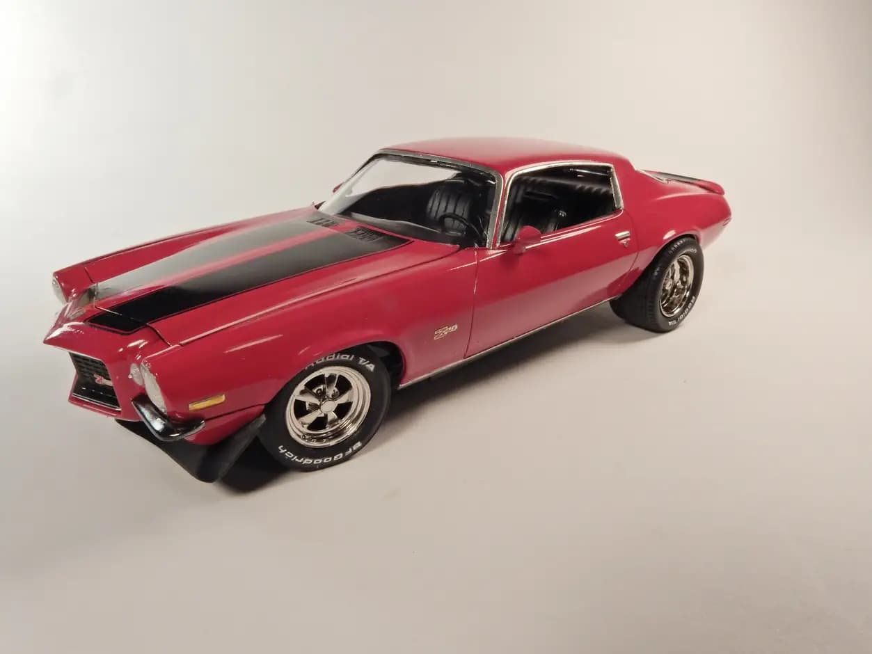

On my Camaro I sanded off the raised Goodyear lettering off of the tires and then smoothed the tire with 4000 grit and then walk through the ranges of 6000, 8000 and finally 12000 grit until the tire sidewall was shiny in appearance. After that I applied the BF Goodrich decals to the sidewalls, applied a light flat coat over them and went with a light dry brushing of dark gray to put some road film wear on the tire sidewall and lettering to blend everything in.

Thanks everyone for the recommendations. Great looking models also!!!. Love the Camaro. I had one of these for my first car at 17.
