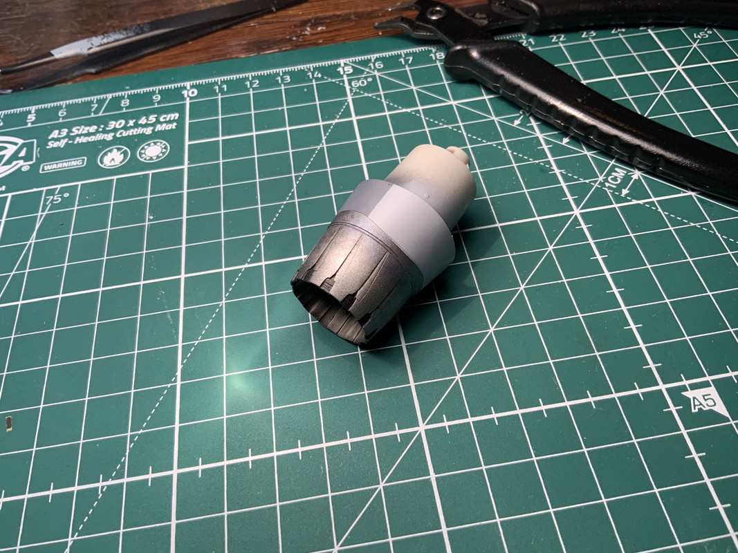

I am a relative newbie and I probably bit off more than I can chew with my first real model build.
I am working on the Tamiya1/48 F14 A and have been trying to get a good look for the exhaust.
I started with a base of Mr Finishing Surface Black. That was followed by a layer of Ak Extreme Metal Stainless Steel. On the nozzles I then added model Master Titanium buffing.
From here I am stuck. I’ve seen various makers do the the light blue highlights but I am not being successful with this at all.
Is there anything I am missing? Any advice or tips to advance the look?

My progress so far. Comments are more than welcome. I won’t get any better without feedback
