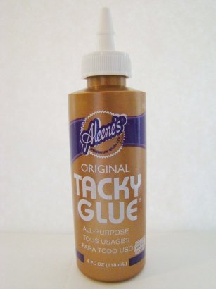

When I came back to the hobby in 2009, I started using the Testors glue you mention. But I stopped using it because it tends to settle after a few days without being used. So every time I was going to use it, I had to press the bottle until all the watery glue came out first and then the good glue started to flow. Shaking the bottle before use didn’t seem to help. I was wasting more glue that way than the one used on the models.
Then I started using Aleene’s Tacky Glue from Michaels or Walmart. It is a lot cheaper than Testors and does the job equally well (or better IMO).Aleene’s is water based glue as well, pretty much like Elmer’s Glue but is tackier. Then I did tried Tamiya Ultra Thin and never looked back. No burns or marring at all on clear parts to report.
