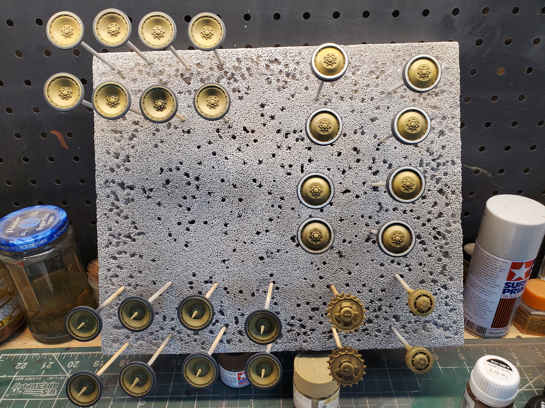

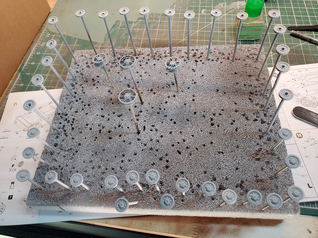

I like to paint each piece individually. I attach the piece to the end of a toothpick (That’s been sanded flat) with a very small of superglue. I have blocks of floral foam that I stick them in.In doing this, I can primer, paint, and weather each piece without actually handling it.

Hey Chris,that reminds me of my road wheel gardens
Hey! A fellow toothpick/foam modeler. My man!!!. They look like they’re growing nicely😉
