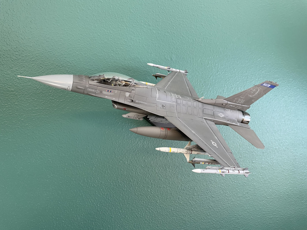

I’m using MRPs lacquers almost exclusively now. They’re kinda pricey, but absolutely trouble-free…which more than makes up for the extra money spent. They go straight from the bottle to the airbrush, and have absolutely no tip dry, even in the high altitude/low humidity environment I live in. Unless they specify otherwise on the bottle, all of their colors are semi-gloss. I thought that was going to be a problem at first, since I mostly build military aircraft. But, as it turns out, its actually an advantage, because it eliminates the step of putting on a gloss clearcoat before putting decals on. It cures completely to an extremely durable finish in less than an hour. The cured product is so nice that it almost looks as if the plastic you painted with it was born that color. No screwing around with this thinner or that retarder…just straight from the bottle to the model. HUGE selection of colors that are perfect matches for military colors from all kinds of different countries…pretty much the full Federal Standard line and LOTS of Russian military colors. A really cool thing I found with it recently is that it is 100% impervious to enamel thinner. So, if you do your base color with it…such as the white landing gear on an F-16, you can then use good old Testors square bottle metallic silver for the bare metal parts, and if you screw up and get that silver paint where you don’t want it…just dampen a q-tip with enamel thinner and wipe it off. It won’t start to dissolve the MRP paint, no matter how much wiping and rubbing you do with it. That’s a first. I haven’t seen a paint yet that doesn’t incur some kind of damage from enamel thinner, but this doesn’t. Heh…as you can see…I’m definitely hooked. Its the Holy Grail of model paint as far as I’m concerned. Its almost more of an ink, in that it atomizes extremely well and lays down very nicely.
Everything on this 1/72 F-16B was painted with MRP paint (except for the bare metal parts on the landing gear and missiles which were Testors square bottle metallic silver of course).

Hey Eaglecash, your F16 looks fantastic. I expanded the image and yeah, the paint looks REALLY tight!
Like you, I don’t mind paying more if it means I don’t have to fight the paint. I am so tired of that. Thanks for advising all this. This paint sounds awesome! I will try it!

Please don’t judge the paint by my amateur building and photography skills![:)]

Sorry, but I WILL judge because I think your F16 looks fantastic! I love your guys work. Your paint looks smooth and nicely applied. Not to mention the subtle shading that you did is really nice. You should be proud of this model. And there is nothing wrong with your photography skills. That looks good too. It has good lighting, it’s nicely exposed, and the image is sharp. What more can you ask for. [Y]
