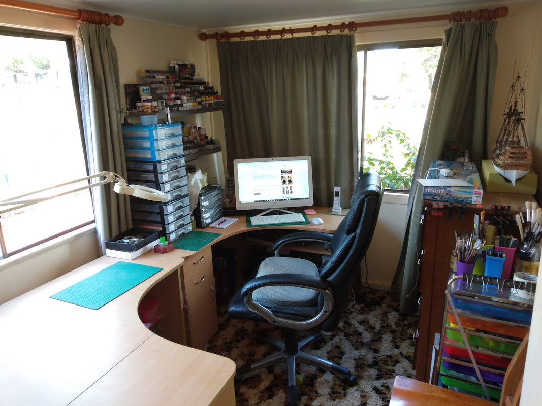

when you live here for so long you get use to it , I do get lovely cool breeze’s through my 2 window’s , and as the hot month’s are so long , it would cost a fortune to continuously run the RC . it’s just the paint doesn’t like it
