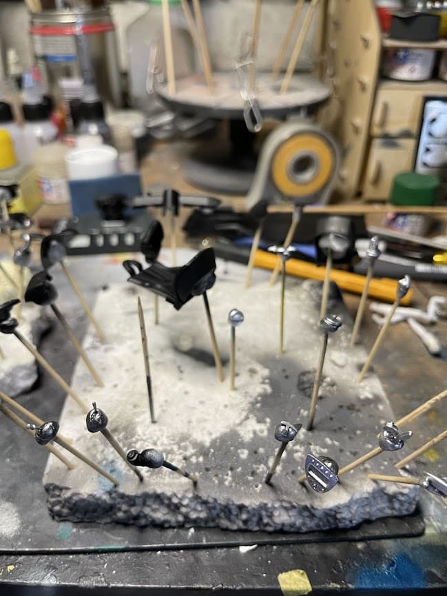

Cutting out and initial pieces glued together
Primed
Colors…

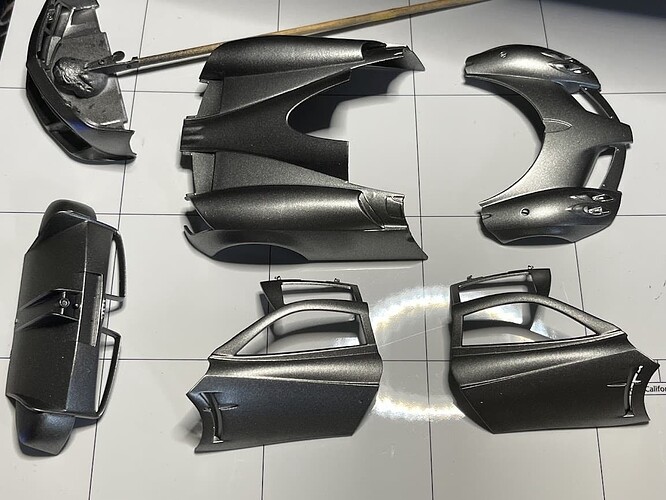

Engine base
Initial exterior base color (tamiya gun metal), will then add a purple layer on top of this.

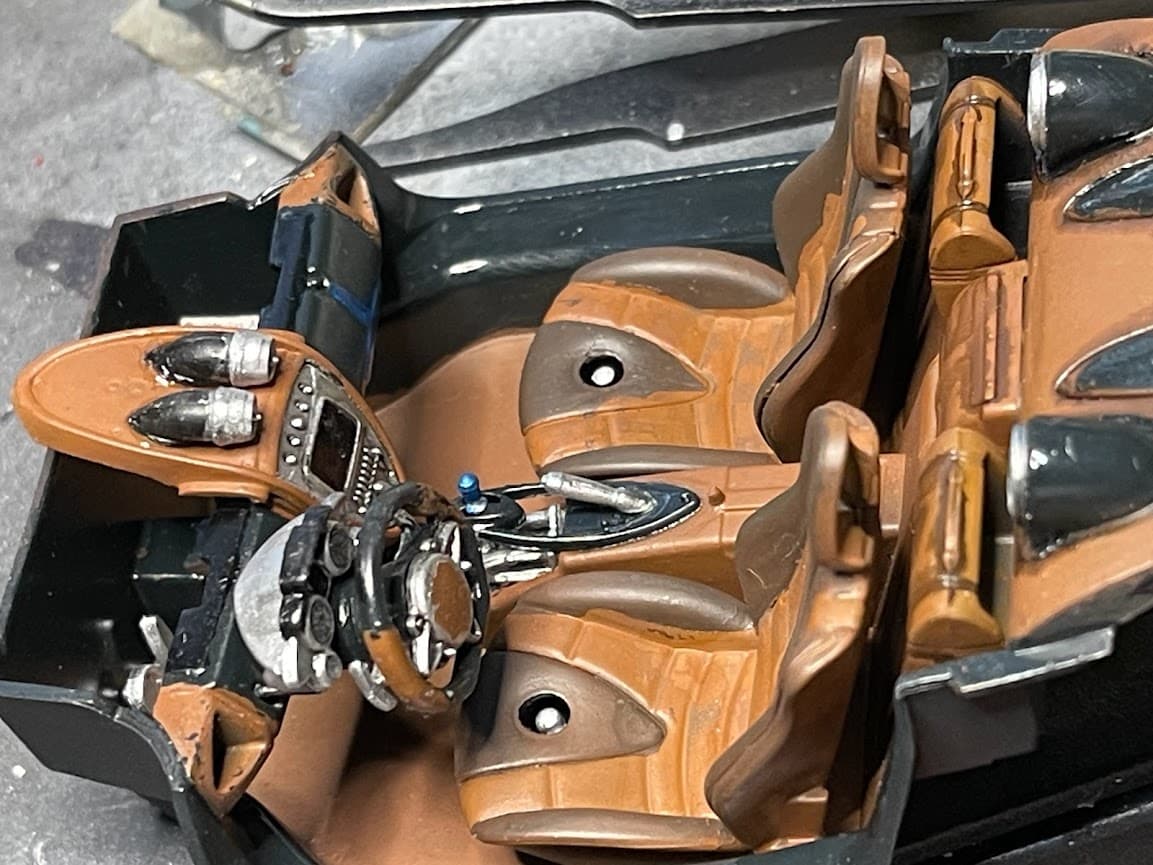

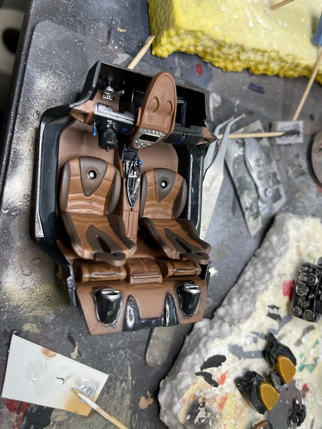

Adding color to interior
trying to add different layers of color to try and simulate leather, not sure how effective it is
Body color before clear coat
Looking very nice. I think the interior color looks good. I always struggle with interior colors, especially when it comes to leather.

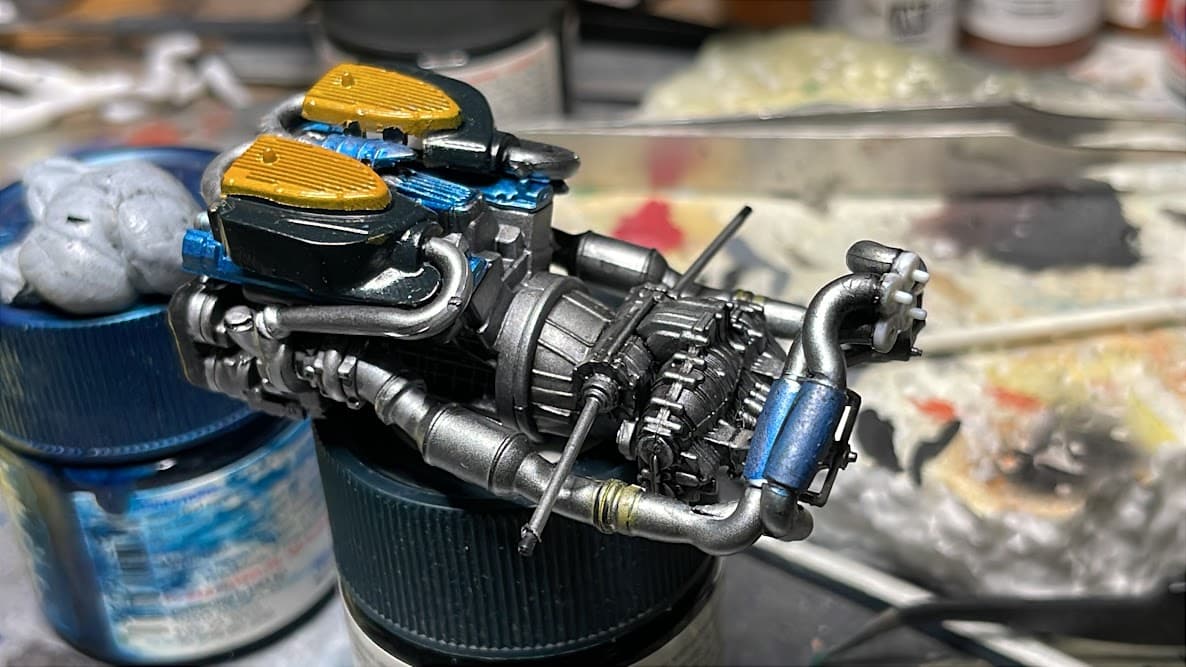

What is the pearlescent paints you use? I like the blue on the engine block.

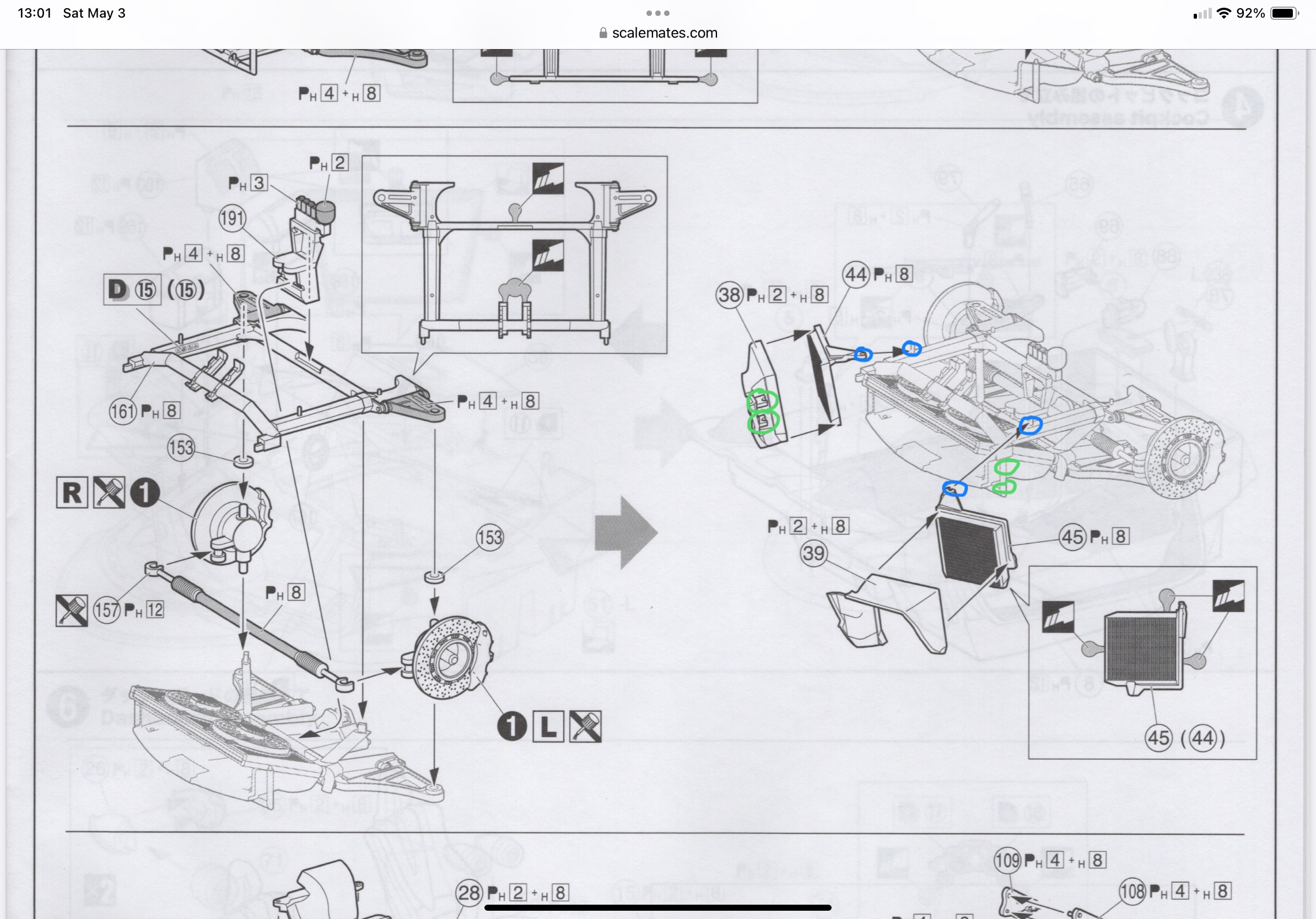

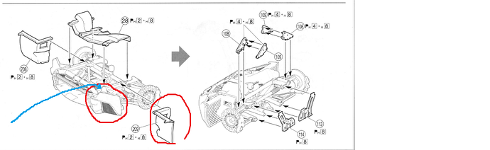

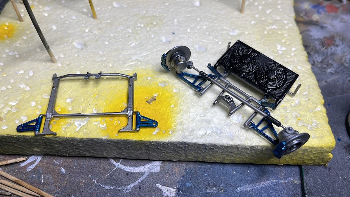

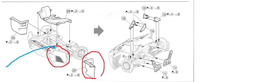

Sigh I’m stumped by the damn model!!!
The two red pieces apparently just float in thin air! And the left most piece has a tiny single point of contact, a little pin that it sort of attaches to (blue arrow), that’s it’s only apparent glue point. First time modeling that I’ve gotten stumped like this in how to make things fit. And everything else in the model fits together great, so I’m even more confused/annoyed at why these two pieces make no apparent sense in how they fit. And if fact honestly don’t seem to fit well at all, I can’t figure out how they would even work in real life :frowning:
Grrrrr
I’ve had models where pieces don’t fit, seams, that kind of thing, but you understood what the guys who put it together were trying to do. But here??? I literally can’t imagine when they modeled it in CAD what happened here?

Tamiya X13 Metallic Blue, absolutely love it!

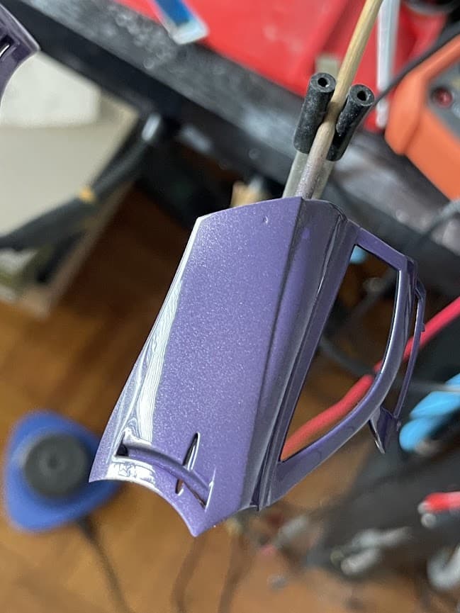

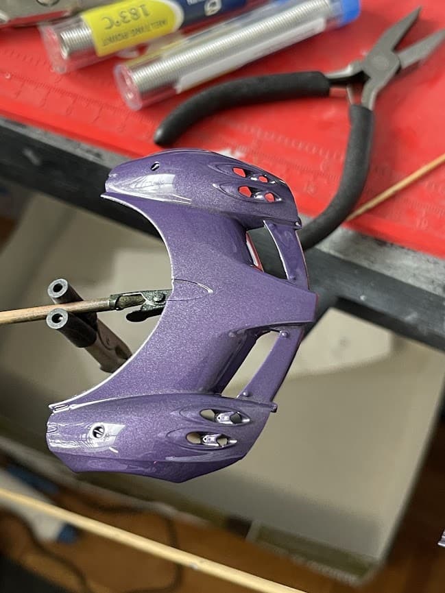

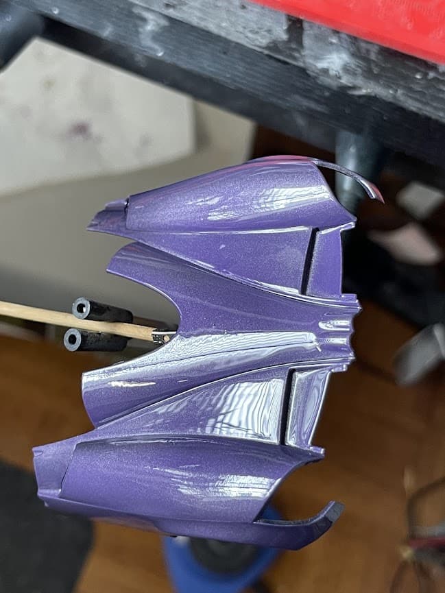

Body
So that’s a black prime, Tamiya X10 base about 1:1 with Mr Color 400 thinner, followed by light purple Tamiya X16 about 1:2 (paint to thinner), and then 3-4 coats of Tamiya Clear X22. Haven’t tried polishing yet.

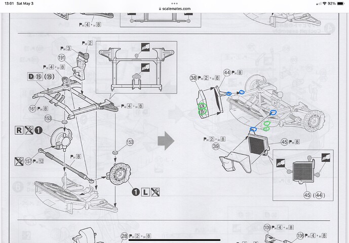

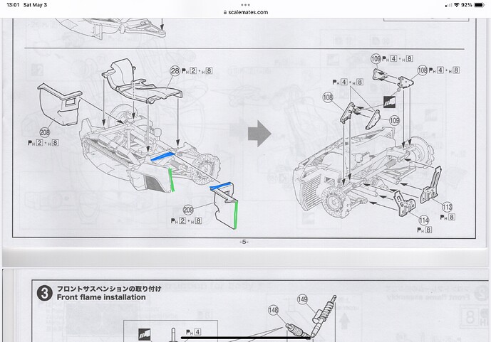

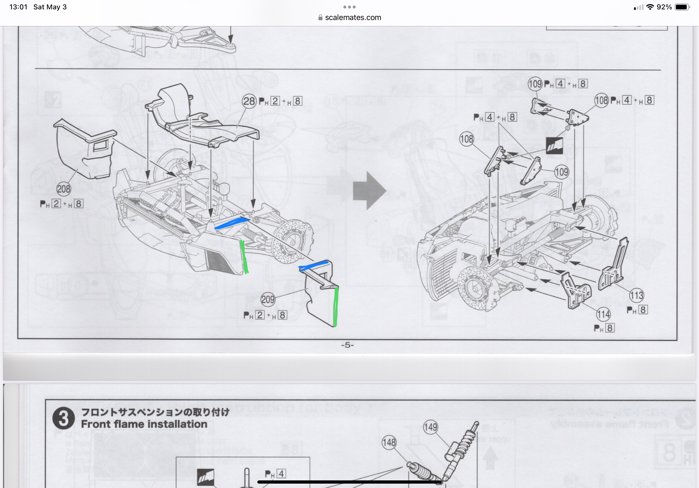

With regards to your attachment problems, what I think I see is this.
It’s not clear but i think pieces 38 and 44 have to be attached together first then part 38 attaches to the vertical bar by the fans. I’ve marked those in green. Once that’s solid part 209 should have good mounting on two surfaces (marked green and blue on the second picture.
If you’ve already tried this and it doesn’t work, then I’m not sure by just looking at the instructions. Hope this helps a bit.
By the way, I really like the colour you’ve chosen.
Yeah I tried something like that before but it just wouldn’t seem to fit right, if you got those little vertical hinges in place, then the bit on the top would be seated right. But… just trying again, if I put on the top piece first (part 28), and then put in the grill like bits, there’s a just right angle that lets it all seat in place and rest properly on the hinges. But OMG it’s really hard to hit that sweet spot, very difficult to see at least for me!
