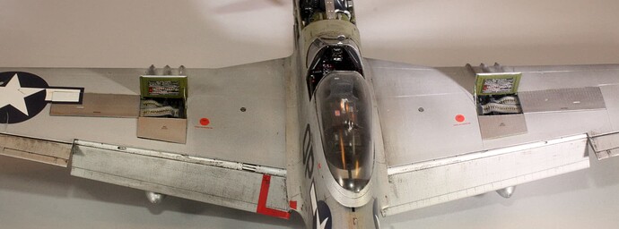

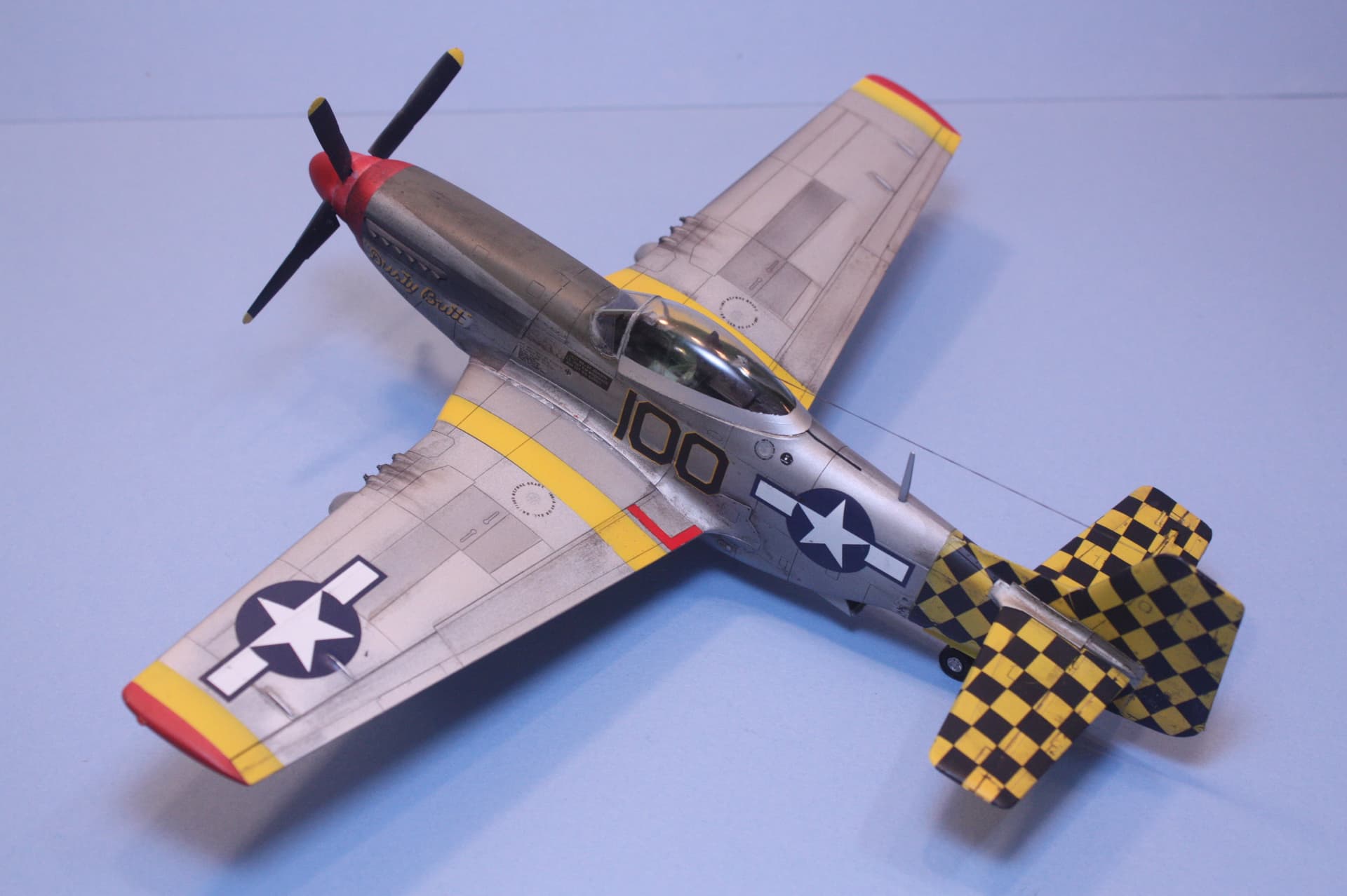

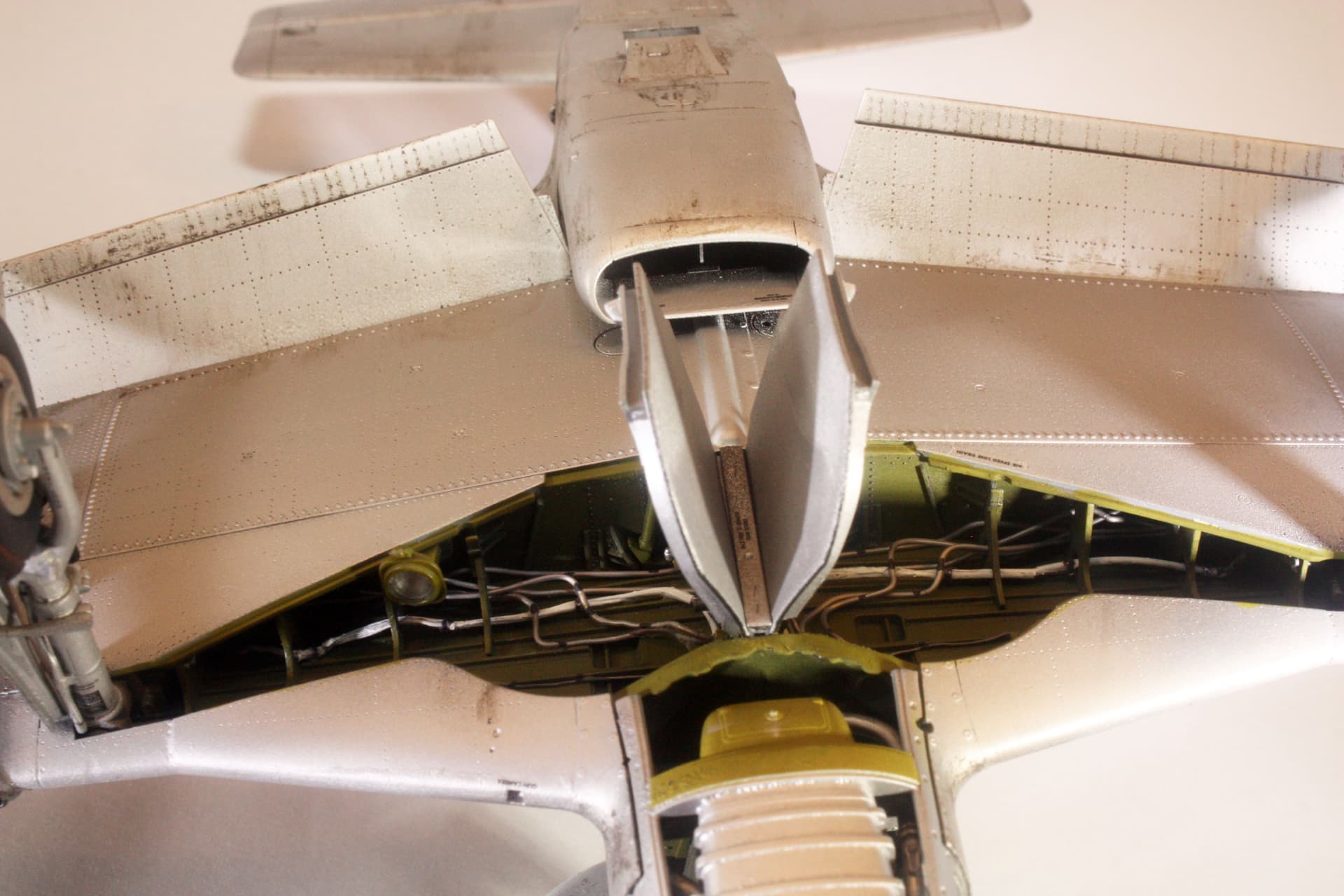

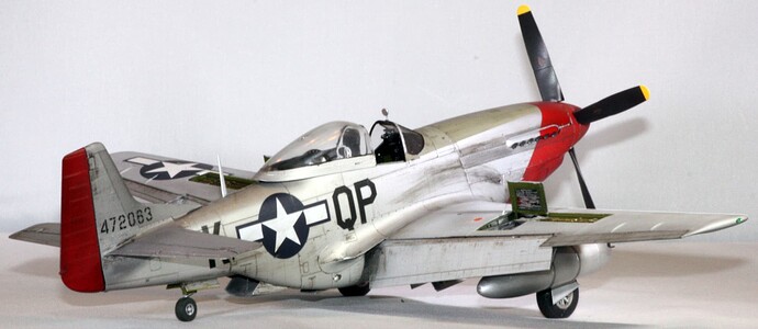

When I’ve built NMF Mustangs, I have tended to paint the base aluminum. Then pick out certain panels, like the gun bay panels on the wings’ upper surfaces, or the two panels immediately in front of the intake on the lower surfaces, with a dark aluminum. Control surfaces will generally get white aluminum.

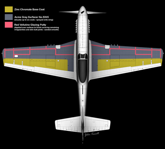

I am certain that I’ve read about some Mustangs with a gray lacquer on the wings to aid in efficient airflow, but I’ve never done one like that.

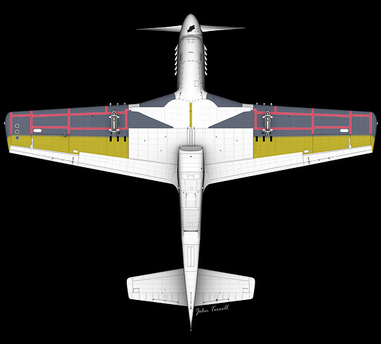

I agree with Steven! The main wings had some of the panel lines towards the leading edged of the wing filled in with putty which created a laminar flow wing.
So the wings would have been painted aluminum while other sections had a polished toned effect.
