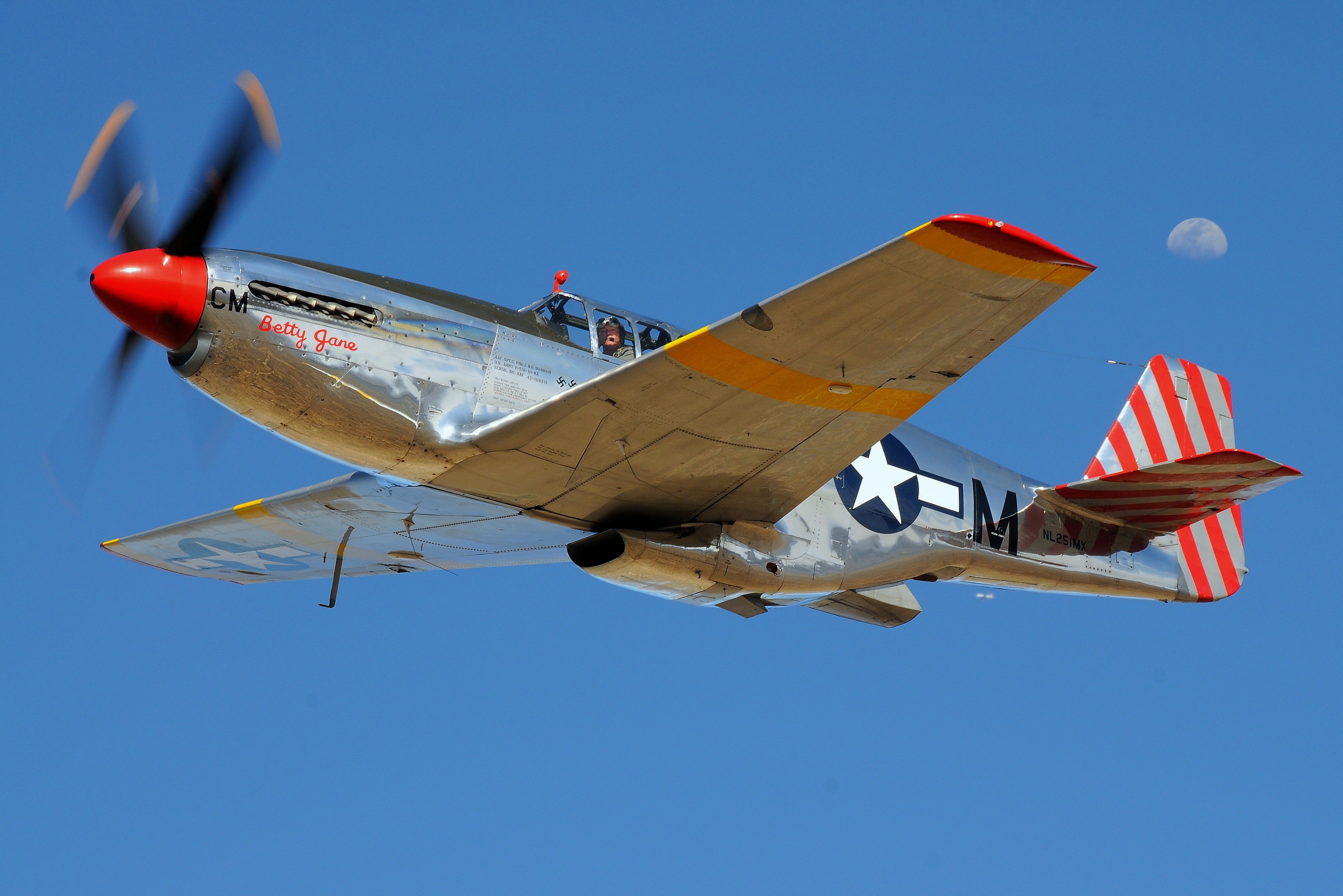

This photo of a (restored) P-51C shows them below the starboard wing:
http://www.collingsfoundation.org/wp-content/uploads/2014/04/TP-51C_11.jpg
-B/C mustangs had Nav lights near the ends of the wings both above and below, while the -D models had them at the very edges of the wings only.
The formation lights on the -B/C was on the right lower wing, inboard of the Nav light. The -D had them on the right also, but moved further outboard, yet still under the wing.
