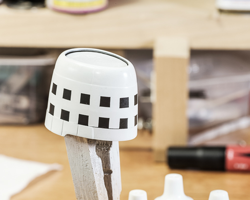

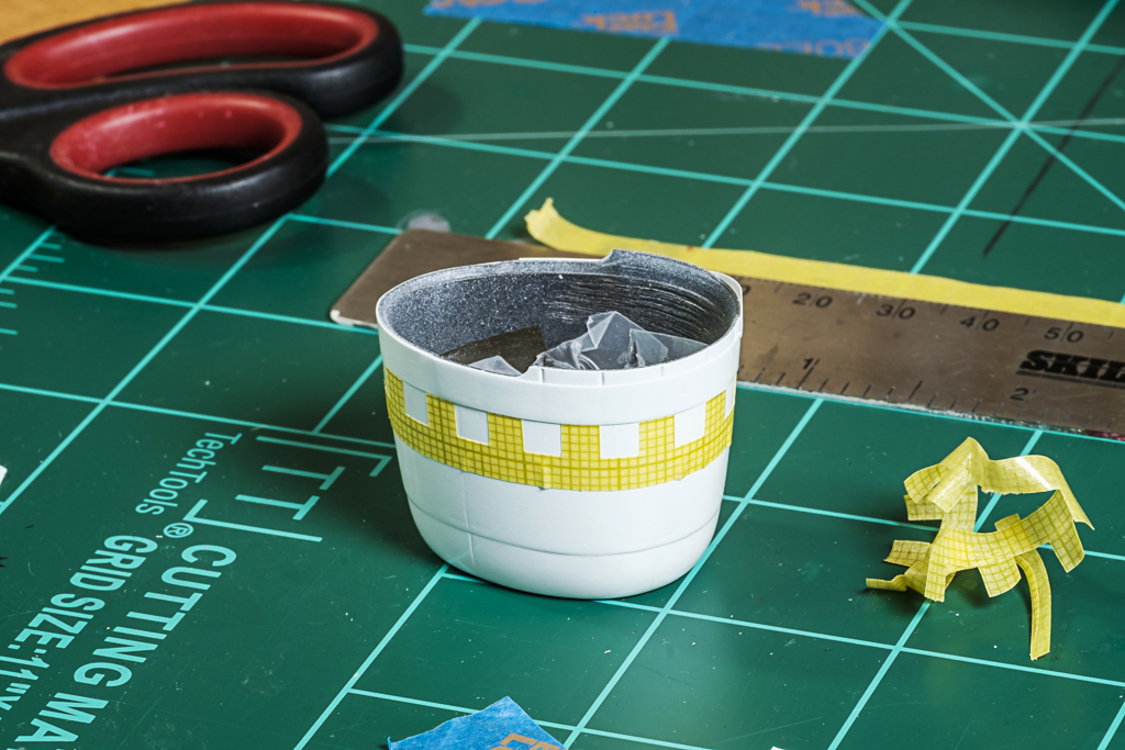

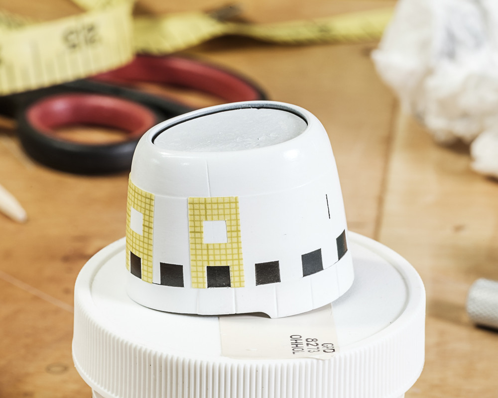

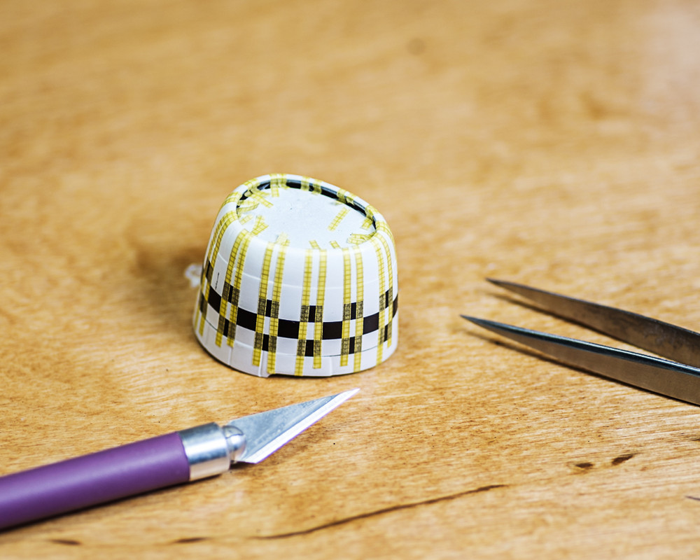

Hi Frank, Luckily I photographed this process extensively. I don’t know how big the squares are. I think what I did was the measure the circumference of the cowling at the rear edge then divided by total number of checkers… From my photos looks like I added the back row first, then the 3rd row from the back, then free had masked the 2nd row, using the 1st and 3rd row as guide.
Next I extended each individual row to the front of the colwing with thin strips of tamiya tape and then used your friend (the Tamiya Vinyl tape) to break up the forward rows into checkers…
I used my silhouette cutter to create masks for the 1st and 3rd rows… HTH

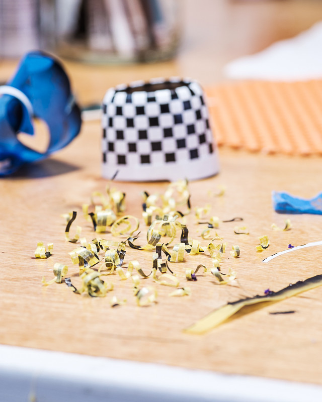

Masking carnage – The ‘After the battle’ photo.
Very, very nicely done. Thanks for sharing your process. I have a Silhouette Portrait but I didn’t cut any stencils, only used tape. I have plans for two more Thunderbolts, one with a yellow and black cowling. I’ll have to try your method. I did measure the circumference of the back of the cowling and at the front. I divided the circumferences by the number of squares and that’s how I came up the the 4mm and 3mm size for the checkerboard.
