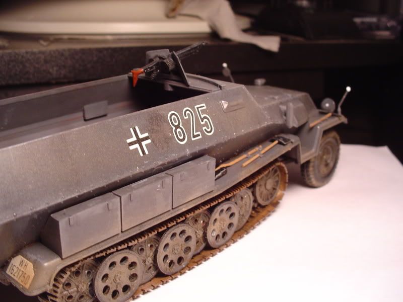

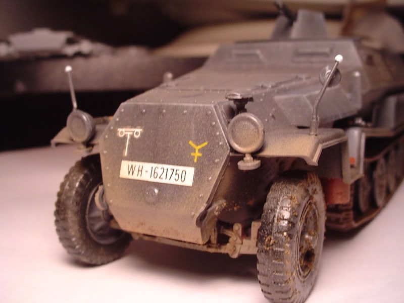

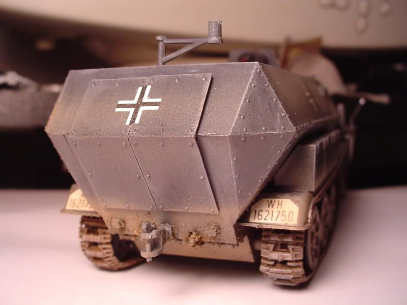

Well, I added some markings and gave it some dust. Going to let it dry tonight and hit it with some dullcoat tomorrow and then call it done! For some reason the tactical marking on the nose has silvered a bit and Im not sure if I can fix that at this point though.

Thanks dragon, my dust is comprised of simply spraying some tan (Testors 921580 to be exact) from a good distance ( about 8-12 inches) from the model. I think I overdid it in some places but I plan on going back and hitting the top of it with some really thinned down Panzer Gray again.
The little “friend” went together without a hitch. Hardest part about it was the gun shield to gun mount. Getting it in place and not glueing the movable part of the gun down was a bit tricky but other than that it was a cinch!
I think the hardest part about the halftrack was getting all the roadwheels glued straight and lined up with each other. Good luck with yours, hope I have helped some!

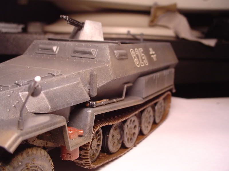

what colors did you use for the hull, artillary piece? how did you do the edge weathering and the rust(?) on the ap? thanks!
I used Tamiya’s XF-63 German Grey on both. The edge weathering was done using artists oils. I mixed Ivory Black with Titanium White until I got a color a few shades lighter than the german grey. I then took a flat brush and just kinda lightly brushed all the edges and angles. The rust was done using an oil wash as well using Burnt Sienna diluted waaaay down to the consisitency of coffee with an odorless paint thinner. Then applied to all the corners crevices and cranny’s and let it flow! Hope that has helped somewhat!
