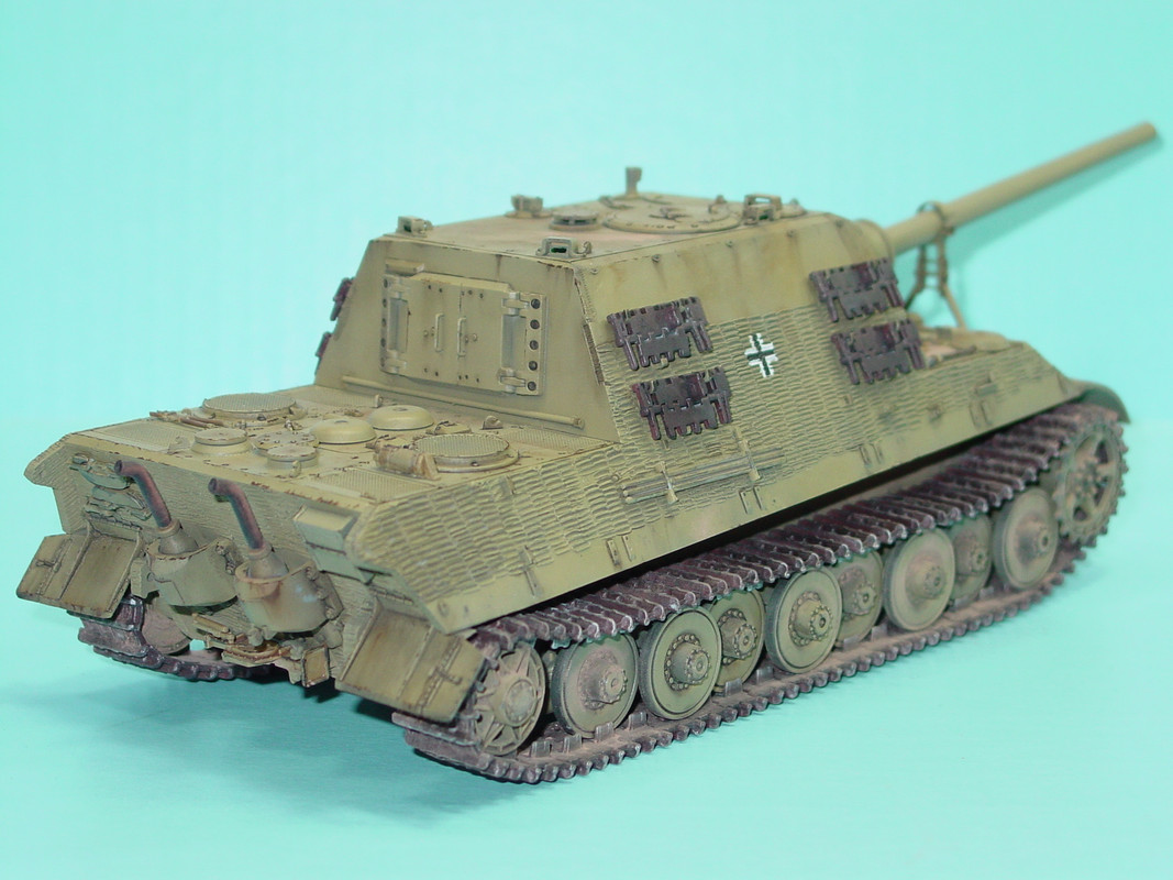

I like using it over solid colors like OD, Panzer Grey and German Yellow. It helps to break up the monotone solid color as with my Porsche Jagdtiger in German Yellow.

I disagree that “gives an unrealistic” finish. Perhaps if overdone, but when done well, it’s as effective a technique as other techniques are to achieve their ends, like pre-shading panel lines.
