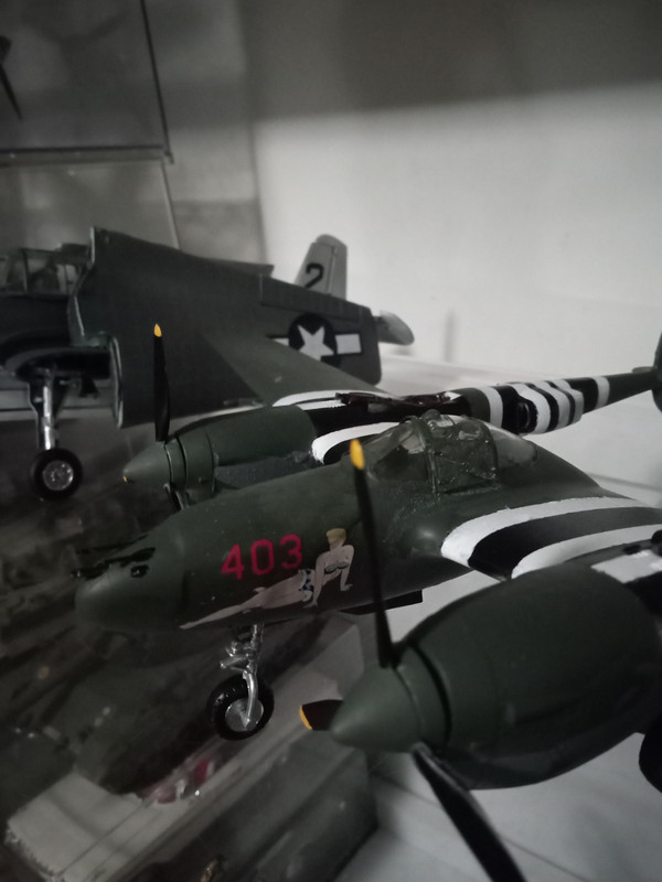

Eugene that’s a great one. Who’s decals did you use?
Est 1961 I signed up for that one too i think, Dodgy’s right? I’ve got some figures for a dio I think I can finally do justice to. This P-38 figure from Tamiya has to be one of the best included in a kit.
Beautiful build of my favorite WWII aircraft! Stunning work sir!
tjs
You Betchya!!Mongoose,Thank You!
I found the pin up gal in my decal stash,I thnk it came from a B-25 kit!
I put her on my 61!
