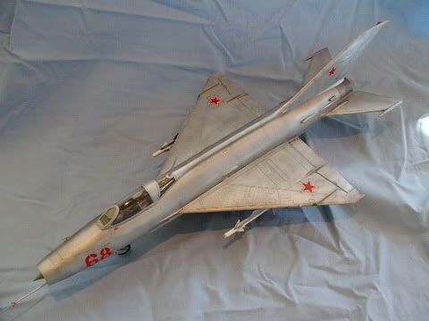

is this the sort of effect you’re trying to recreate?
It’s done with pre-shading the panel lines with black acrylic. then the alclad went on top of it. then i applied a thinned acylic black wash to give it the streaks and sooty look.
Alclad offers a “dull Aluminum” color to help with your project.

LC: THat’s it exactly…and thank you for the “know-how”. Which Alclad did you use? I have a few bottles of “aluminum”, and if I don’t have to buy a different one, I’d prefer to use what I have. Crockett mentioned the “Dull Aluminum” which to me sounds more proper, but if I can re-create what you;ve done with the regular stuff I’ll give it a shot.
Oh, and another thing: does “thinned black wash” mean something like a thinned Tamiya smoke color? Is the wash sprayed on?

No problem. I used regular alclad aluminum. The primer was mr surface 1200.
The thinned black wash was a mixture of 1part gunze flat black + 9 parts water + 2 parts dish detergent. It was applied with a paint brush all over the model, section by section. let dry for a couple minutes, then wiped away with a damp cloth to create the streaks. the dish soap will let you wipe away most of the black. if you want it dirtier, then use less soap (just like dishes hehe).
i did not apply a dull coat, otherwise it’ll destroy the metallic sheen of alclad.
