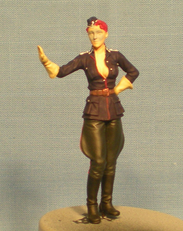

To illustrate, here’s a 1/20 scale figure I was working on. I gave her a black eye:

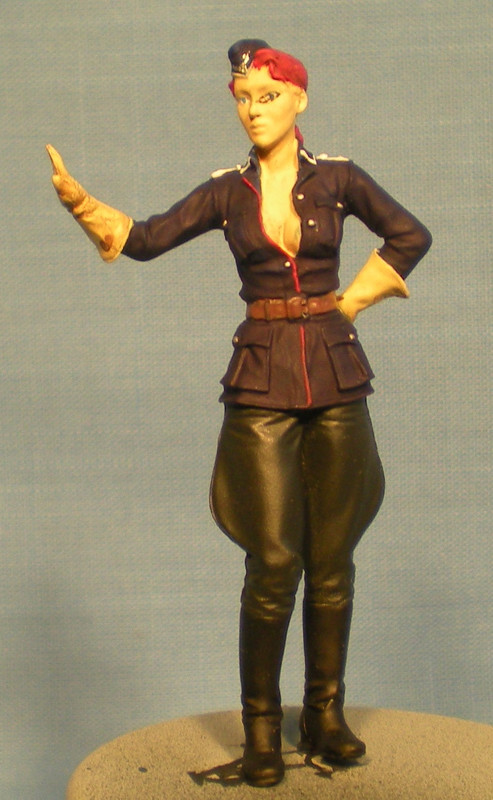

In this photo, you can see how I removed the paint from that specific area, using a Q-tip soaked in SuperClean:
The same process should work to remove the paper. Once you’ve got it cleaned off, just wipe down the area and re-apply your primer.
Hope that helps!
