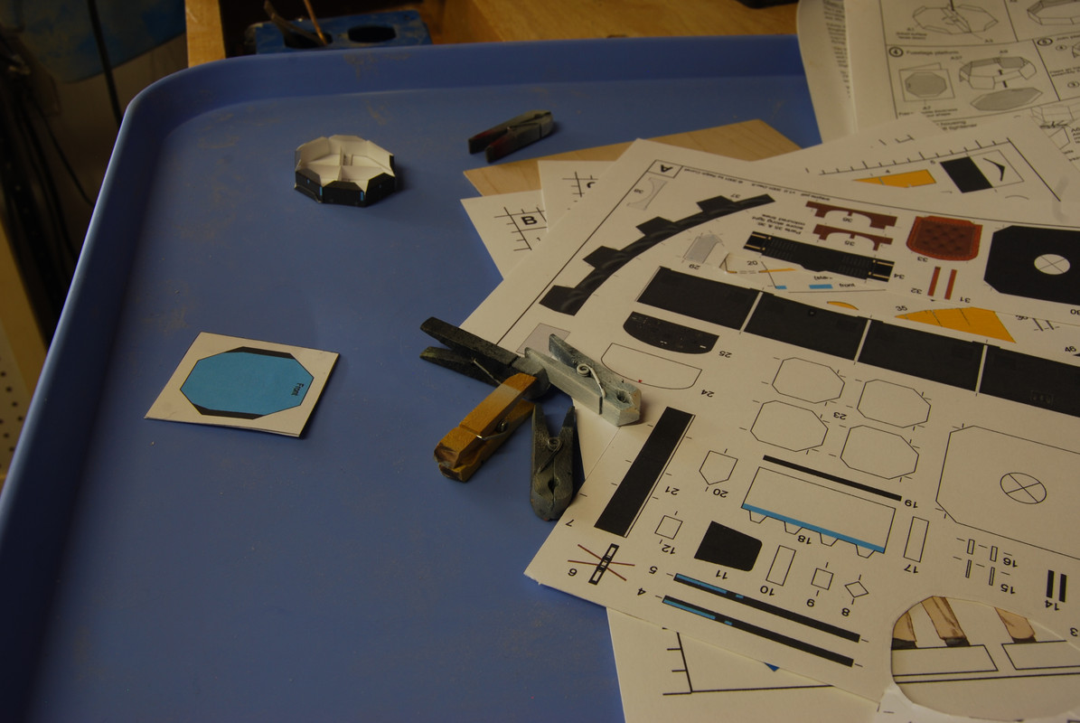

I bent the tabs on the turntable base a little too far to the outside and now it will not fit within walls. I should have not closed the walls before, and wrapped it around the base before gluing ends :=(

I don’t quite get it - what tabs do you mean? Is the part that will not fit the blue one, on heavier cardboard?
In paper models it’s a common problem that a bulkhead doesn’t fit - it’s usually too large, because the designer often forgets to the thickness of the paper into account. Please remember, that you always have the option to sand the bulkhead down before installing it. I hope it help, or if I don’t understand the problem right, please post more photos and I hope we can figure it out together!

The base the sidewalls are sitting on- the piece with the X-brace. I think I will just cut the tab on the sidewalls- I am afraid to rescribe the base by only a few mil- I am not sure I can scribe that accurately. I’ll try to treat the open seam with something.
